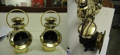

Instead of working the alternator, I went with gas lamps.
