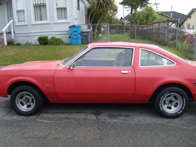

the po has it way jacked up i kinda wanna lower it give it more muscle stance do i loosen those nuts on the threaded shaft on either sides of the engine looks like they go thru the k member. i know how to on my a-body but this is a lil more advanced and high tech compared to my 63 if anyone is somewhere where its not wet and cold and raining if they could get a pick of where i go to do this
as seen here its high up there makes the ride feel more boatish then if it was lowerd in my opion is this true?
thanks guys
It is much easier if you take the weight off the car. You can use the bumper jack or floor jack on the frame (not the lower control arm). The bolt head is pointing down angled toward the bumper. Bolt on the driver side adjusts the pass height and vice versa. You can do both at the same time just use 2 jacks and count the number of turns. I did my 79 f body one side at a time and I'm lower on the pass side to account for me and the battery. If you open the hood and stare down at the frame rail just behind the radiatoe you may see the threaded tail of the other end of the adjusting bolt (pointing up angled back at firewall)
