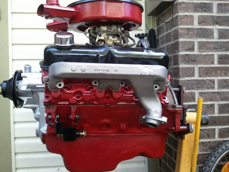

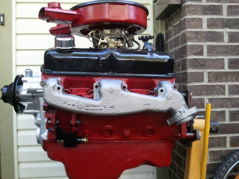

Anybody run the 5.2/5.9 Magnum exhaust manifolds? I heard they flow identical to 340 manifolds. I just wondered if they cleared okay..
Thanks to shorty I looked back at the pictures I posted and realized that they will not work on LA heads due to the diagonal bolt pattern...oops...:thatswck:Thought magnums did away with the diagonal bolt pattern on the ends ? Looks good though !
