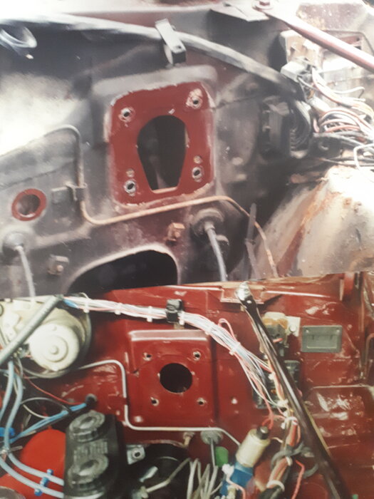

May 25, 2022 #2 SRTMirada Well-Known Member Joined Dec 29, 2015 Messages 103 Reaction score 68 Location Niagara On a 1980 Mirada it's a bolt on using f-body parts. On a 1981 and later the firewall needs to be modified slightly as you can see in the picture.
May 25, 2022 #3 J jbyrd6 Member Joined Nov 3, 2017 Messages 11 Reaction score 0 Location 53405 What's different on the 81- later firewalls? It looks like the center opening is larger. I was hoping I could just use one of these:
May 25, 2022 #4 SRTMirada Well-Known Member Joined Dec 29, 2015 Messages 103 Reaction score 68 Location Niagara The top picture is a 1980. The bottom is a 1981. If you open up your 1982 firewall to look like the 1980 one then your stiffener plate will bolt right on. Bolt the stiffener plate onto the firewall and use a scriber to mark what needs to be done. Last edited: May 25, 2022
