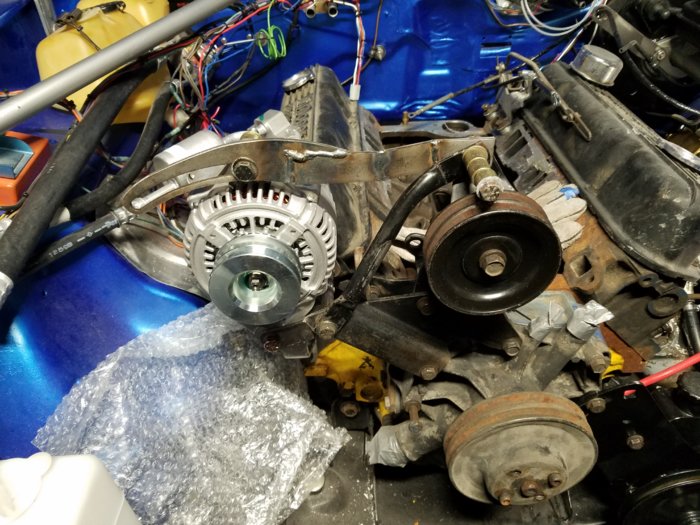

Not necessarily. The smaller pulley in the first picture was designed to bolt into the ahb/hd alternator bracket because it also holds the newer compressor. 80s vehicles with no a.c. and the normal style alternator could still use the big pulley bracket because they used different alternator brackets and have nothing else to bolt the smaller pulley to.

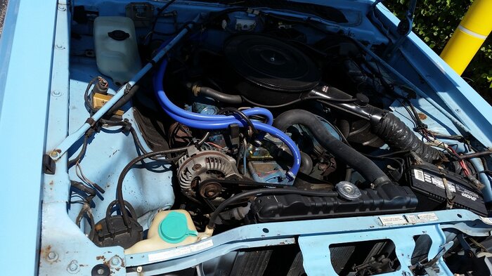

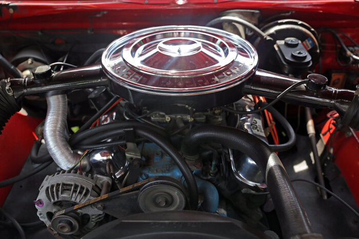

I don't remember ever seeing one on a car, either, maybe the odd diplomat years ago. Most of the non a.c. pulleys I see are on trucks and they are always the smaller ones in that big hd alternator bracket with a denso alternator. To avoid anyone's confusion here is the two different 80s bracket setups. Both on a Chrysler both pics stolen. All 88/89s had the heavy duty type set up.

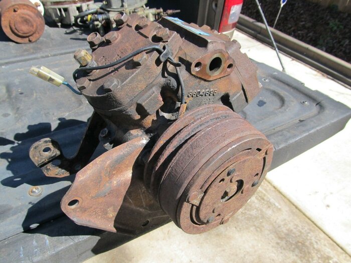

C171 compressor bracket on 74 cast iron spread bore intake. Does not fit. You can’t put the heater hose on, and it hits the thermostat housing.

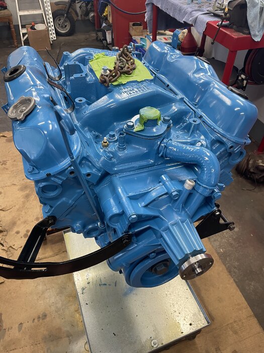

You would need a later than 1979 intake that has the offset thermostat housing and moved heater hose and temp sensor like this intake. Everything is offset to the left bank.
