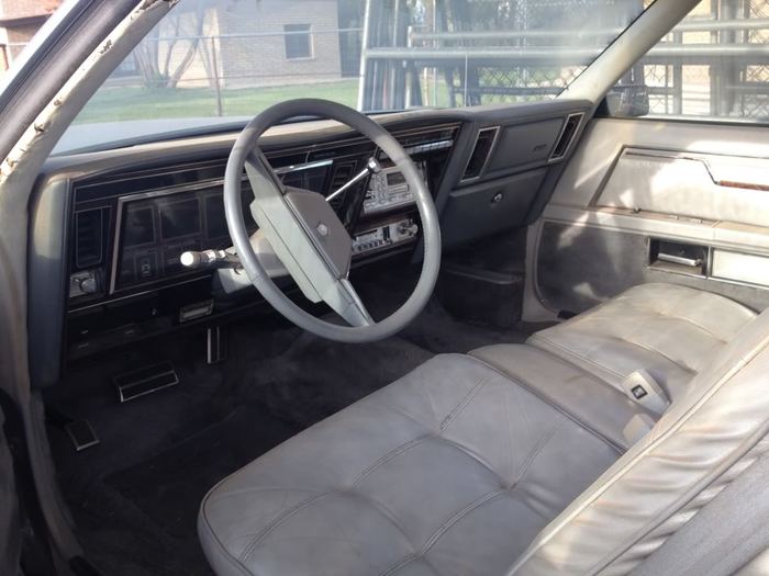

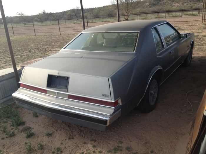

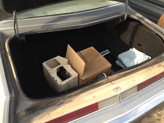

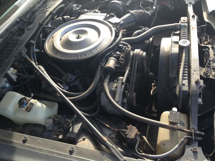

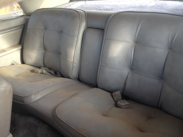

$1200. EFI on engine, spare setup in box in trunk. 126,xxx on clock, no asterisk. Have a couple of minor wire repairs in the engine bay due to packrats. Has the snowflake wheels, once I have replacement wheels/tires these will go up for sale. This will not be a restoration as much as a resto-modification. Interior's only fault so far is falling headliner and fabric cooking around the A and C pillars. Seats are miraculously good, for the car having sat outside in Arizona. May try to fix wiring before summer (I go to Washington State all summer, I'll play with my Mirada then.)
Thinking TX9 black, chrome polished. I'm looking at MegaSquirt 2 EFI system for a even more worked 318. Looking at auto and manual trans options...I'm pretty sure I still have the pedals from my old Diplomat. But the miracle is how mint it is...dusty and dirty, but damn...what a find!

If you don't already have a troubleshooting manual for the car, don't pull/disconnect/alter anything until you read up on the system. Go out to the Imperialclub.com and read, read, read.
http://www.imperialclub.com/Repair/Year/1981-1983/index.htm
A ton of issues can be resolved by a few simple fixes - Air cleaner lid on and tight, auto shut-down module independently grounded, and a couple more. As I said, please read up and you may just leave it as is and drive it!
