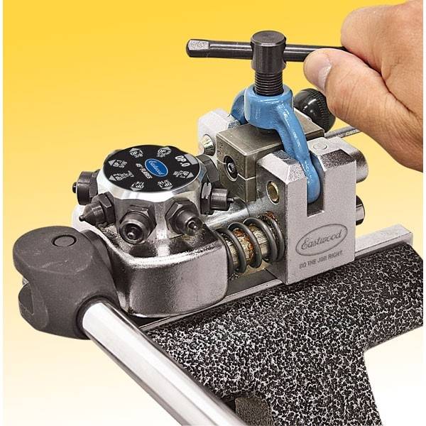

Eastwood nice flare tool finally arrived (regular flare line tools suck big time) and eager to start using it. Now I need some good benders.

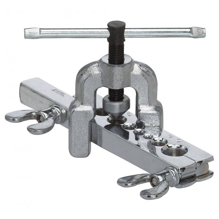

A CHEAP flare tool. Note how wing-nuts get in your way making the tubes on both sides unusable. When you do get a straight shot, then twisting motion damages the flare.
A nice flare tool. No twisting motion used. Takes much less time and end results are perfect every time.

As with a lot of things, the tools make the job. Sometimes a "cheap" tool will be just fine while other times (like tubing flaring, bending, etc) the tool makes the job.
I've got the "cheap" flare tool, although it is a Snap-On and works half ways decent. At work, the shop has one similar to the Eastwood unit to do both double and bubble flares in SAE or metric tubing. As you said, perfect flare every time. Good thing too, being in the so called "salt belt" we go through brake line like it's going out of style.
