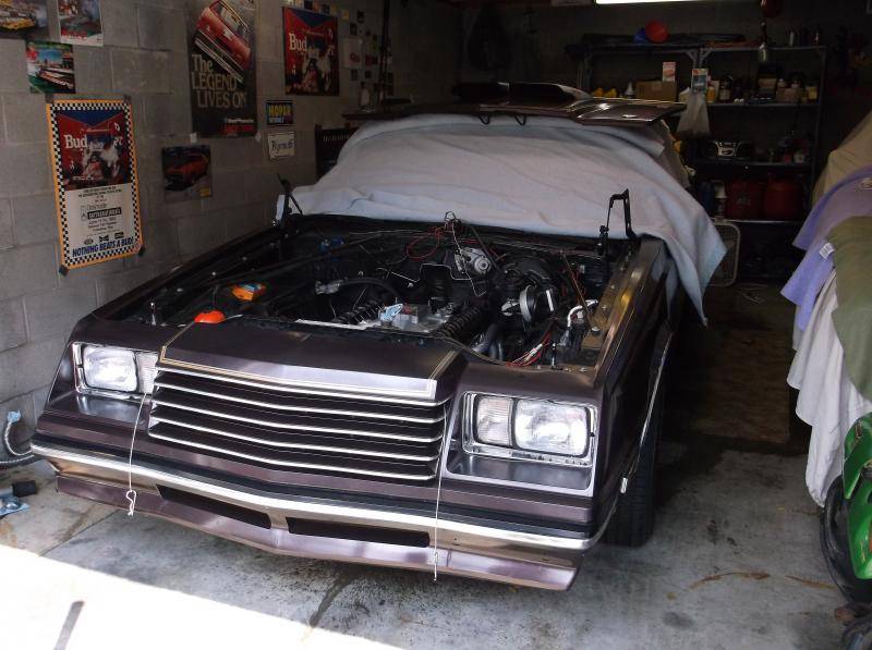

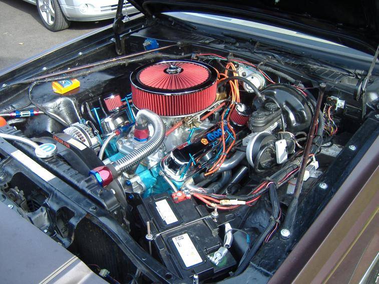

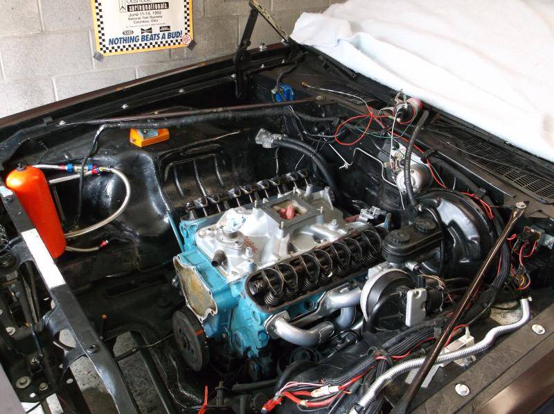

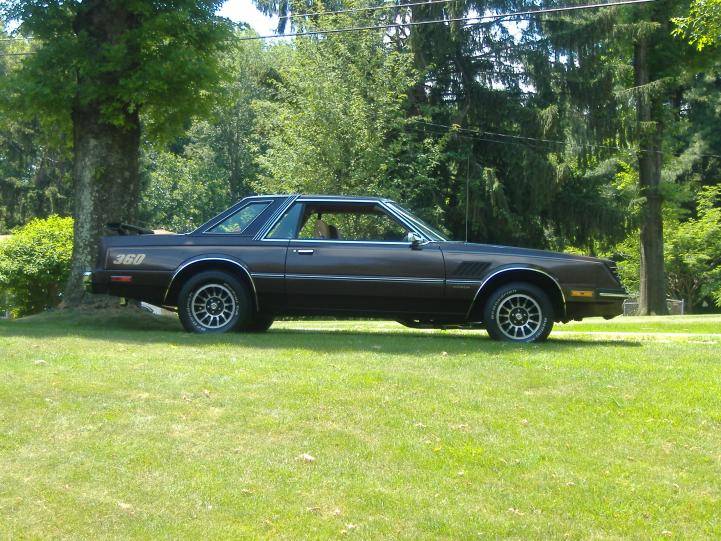

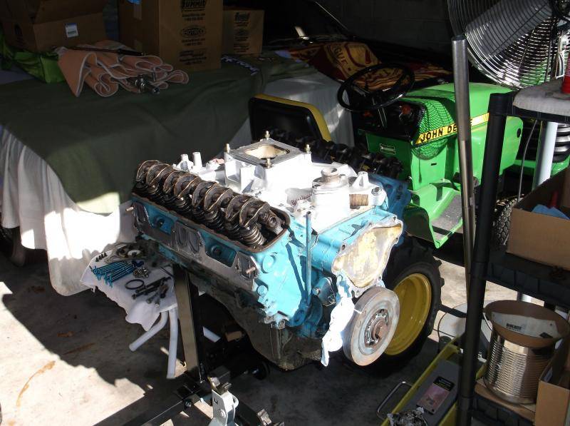

New engine is a 90's 360 magnum block, 30' over 408 stroker. It has Kb pistons 11to1 CR, comp cam XR292HR-10, engine pro roller rockers, edlebrock aluminum heads and an edlebrock air gap intake.

Oh My! That's gonna be fun! Looks like I'll be seeing Your taillights next time!

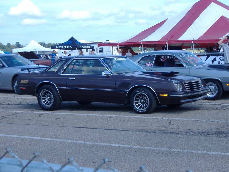

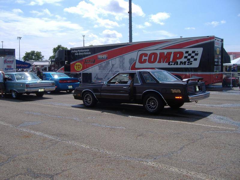

Few more updates for you, went to the Mopar Nationals and went a best of 13.7 at 100.8 mph with a 2.2 60ft. Was running street tires with the original transmission and torque convertor, only leaving the lineat 800rpm cause i still had to drive it home. I now have the old lock-up transmission out of the car and am getting a new Cope Racing Transmission 904 with a new 3500 stall convertor. So itll be much faster next year. Since i have the car up in the air i am putting subframe connectors on and a driveshaft loop. Im also going to be getting another set of wheels to put some drag radials on for when im at the track, so was curious what size wheel other people are running on the back as well as what is the backspacing and offset of the wheels? Plan on running a 275/60r15 tire. I was also considering changing out the shocks while im at it, any suggestions?

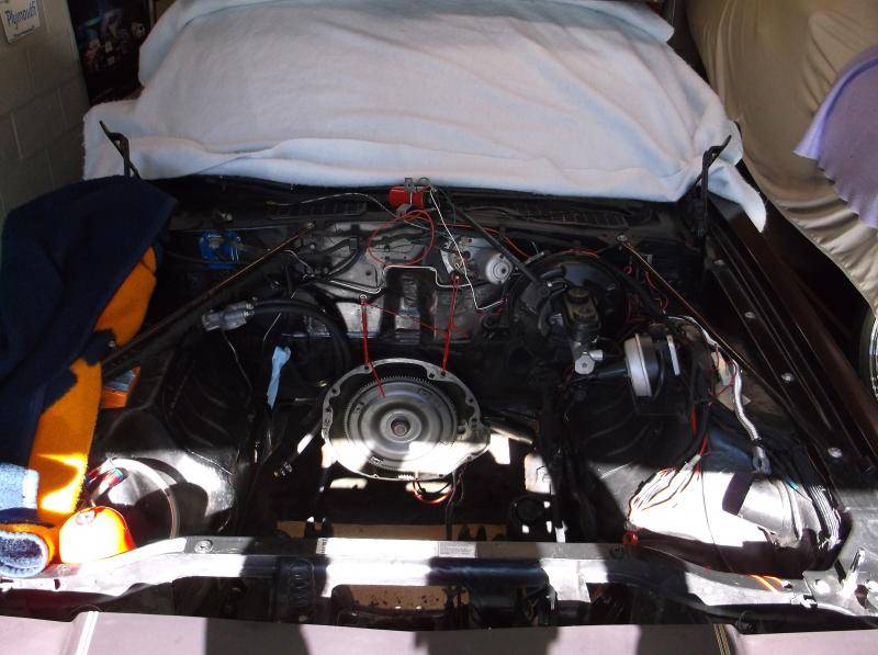

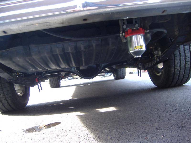

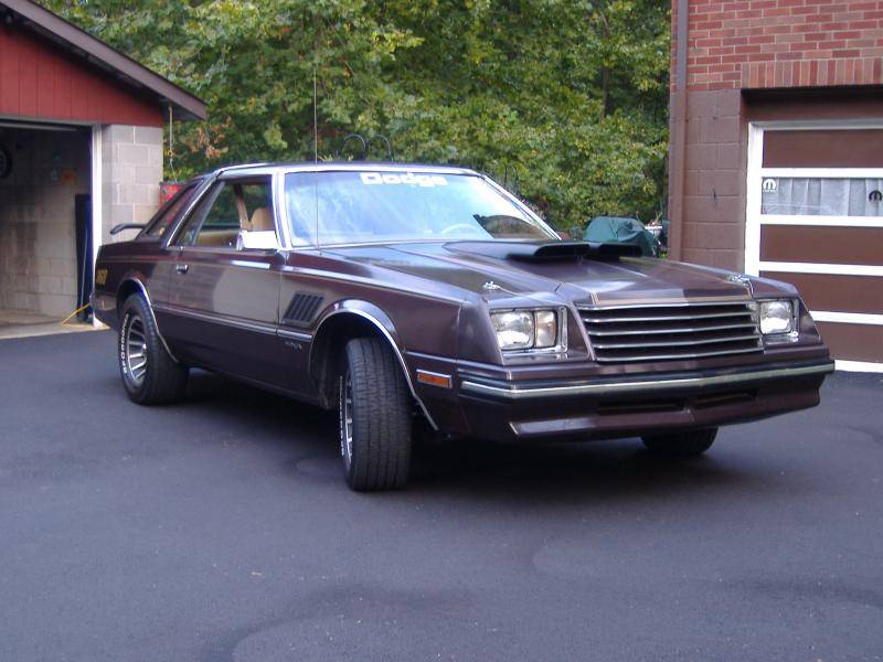

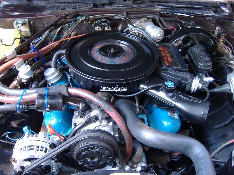

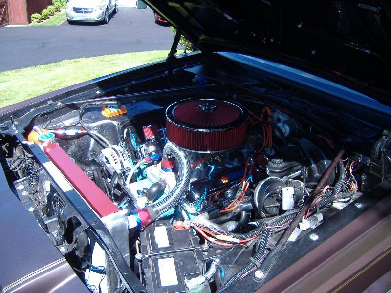

Figured its easier to post my more current pictures here so that they are all in one place. First one is pretty cool cause its in front of the old West Virginia State Penitentiary. Second is a picture of the transmission I just put in. The third and fourth are pictures of my engine as it is now. Differences from before are all msd ignition... which includes wires, ignition box, and distributor...and the dual electric fan set up. And finally the new switch panel, which cleaned the interior up.
