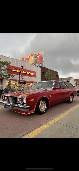

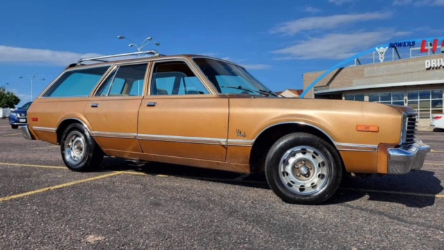

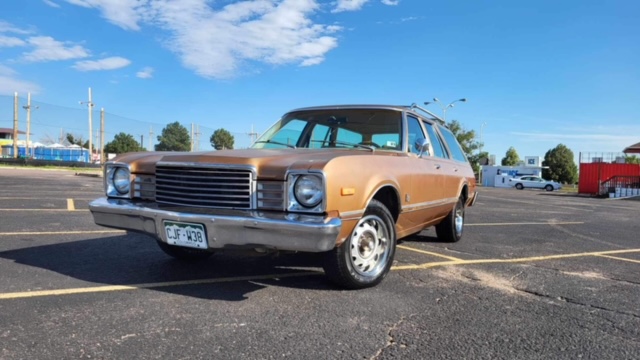

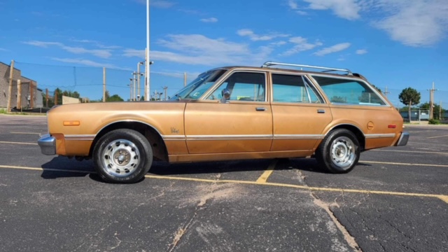

Here are some pics, however it will be getting steelies and dog dish caps in the near future.
Casey FJ

Since it hasn't been mentioned, I'll state the obvious: it has an Aspen grille & signal lights.
The grilles on these cars are more fragile than grandma's china. I'm not surprised it's been replaced
