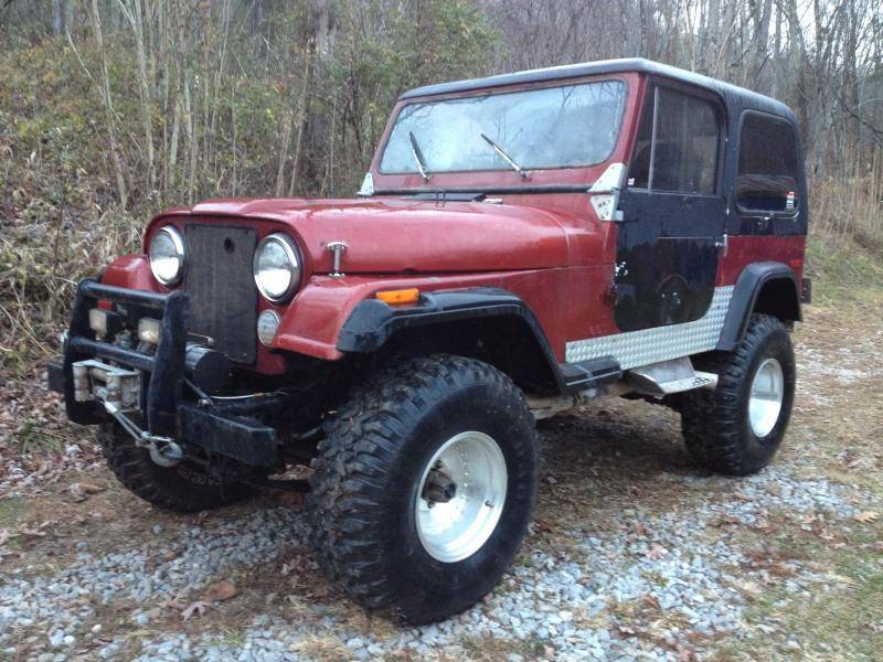

So this is my new project. It doesn't really fit this site but I am sure there are some fellas on here that have experience with these that can give me some guidance.
Never had one before, always wanted one so we shall see how this goes.
Tub and frame are solid, it has a couple of golf ball size holes under the taillights. the inside has been cleaned and rhino lined.
It is an AMC 360, 4 speed with a dana 300 t-case and a twin stick conversion. Has new lift springs and 35's. The 360 is rattling and has low oil pressure so I am unsure if I will put another AMC 360 in it or swap to a mopar smallblock:)
I got it for 3k it has a milemarker winch and a high lift jack.
