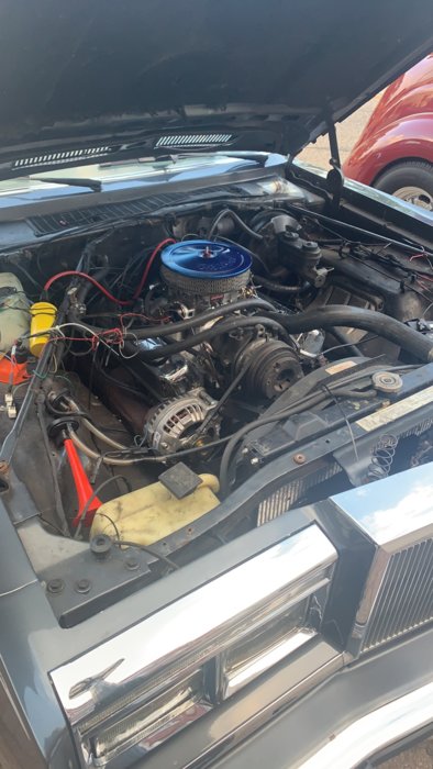

Nope this is the setup
a edelbrock 1403 carb and performer intake

I can see your problem from here.
It's that open air filter housing.
Any fumes happening at shut down, escape straight to atmosphere, and since they are lighter than air, will sit right up under the hood, trying to escape where ever they can, like between the hood and the fenders and up into the cowl past a poorly sealing cowl-seal.
But , you say, those fumes shoudn't be escaping should they?
Well why do you think Ma Mopar designed; the charcoal canister, the sealed air cleaner housing, and the automatic bowl-vent closing system? With all those vacuum lines.
Yur not doing your engine any favors feeding it hot underhood air; it tends to cook the gas, and limits power production.
Imagine your engine being force-fed the hot air coming from the rad blasted at it by the factory A/C fan. When you shut it off, the carb could already be at 200*F or more degrees.... and the lightest aromatics in the gas evaporate at 95*F, most at less than 200*F, the syrup takes a bit more, close to 400* I seem to remember.
And if the that intake has an EGR on it or even just a functional crossover passage underneath the carb, there is hot exhaust in there up to, in the range of 800 to 1000 degrees,cooking the carb right there. Criminy the exhaust can be 350/400 just at idle.
But that air cleaner "housing" sure looks pretty.

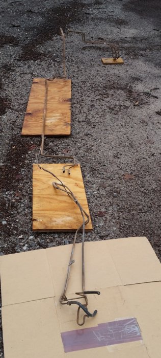

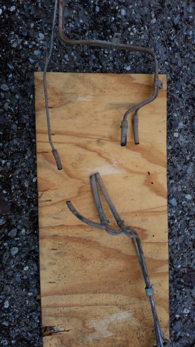

I’m not convinced that it is all fuel from carburetor bowls. Could be the only source but I suspect there might be something else (maybe).
There are three metal lines coming from the fuel tank: 5/16”, 1/4” and 3/16”.
The 5/16” line goes to the fuel pump from frame rail.
The 1/4” line goes from fuel filter back to frame rail (excess fuel return to tank)
The 3/16” line goes more forward and to the charcoal canister (fuel tank vapor feed).
All three metal lines have a rubber hose connection underneath car close to the firewall (as shown below).
From there, all three lines go to the fuel tank.
That is nine possible leaks from the rubber hose sections. Before the engine, there are six different metal fuel lines that might have suffered physical damage and/or rust through.
This is from a '84 Gran Fury 318. The second picture shows the hoses by the firewall under car. I saved these so I could make duplicate lines for my cars, out of stainless (just another project I've yet to tackle).

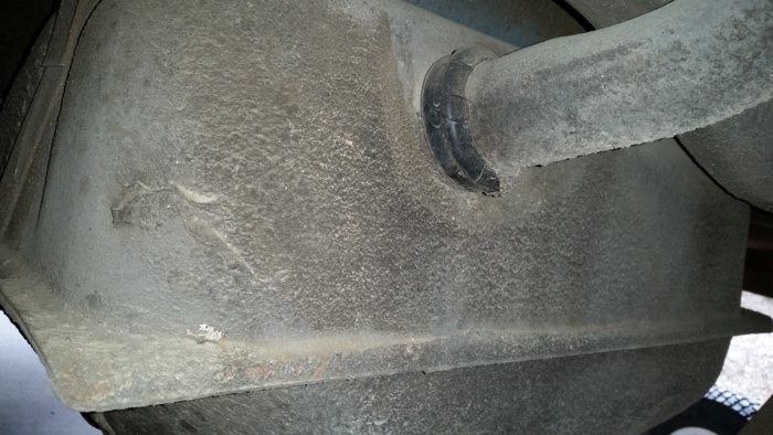

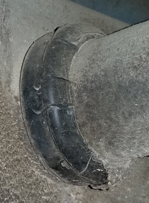

The fuel filler neck grommet (to tank) is another common leak. Dodge part number 4002010 – which is still available. The MSRP is $18.10 (US) though (as of today).
This how crackled the grommet is on my wagon. I’ve seen a couple at the pull-a-part that are “almost gone”.

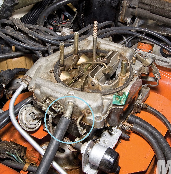

Also, the Charcoal canister has three (of four) hoses going to it. The 3/16” hose from tank, a large and small hose from carburetor (which one or both might be disconnected) with the different carburetor installed.
The big carburetor hose comes from carburetor top and is used to capture fuel vapors that come from it (mostly at engine turnoff). If this one is not used (might not have a provision on existing carburetor) you will need to cap this off at the charcoal canister. The small vacuum hose pulls a small vacuum to the charcoal canister which sucks those fuel vapors down to be burned off. Some systems use manifold vacuum (base of carburetor) and some use venturi vacuum. Some use a fourth hose as a turn on/off valve (for 4-port charcoal canisters).
This is an A-body TQ. The blue circle shows the large hose for vapor collection.
Another possibility might be if the charcoal canister is not getting any vacuum it might be saturated with fuel vapors – for charcoal can only hold so much.
