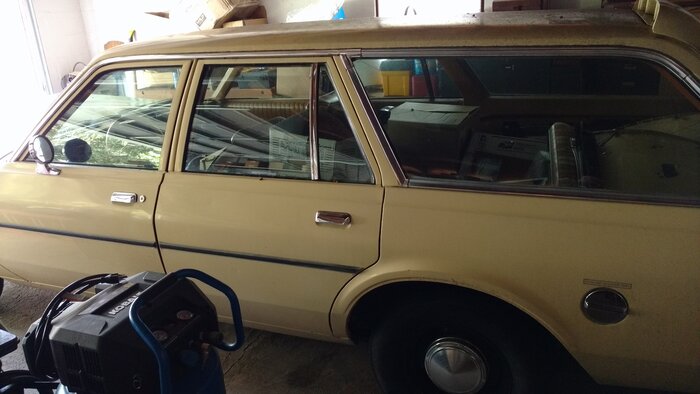

OY pics and plans
we can sure give a lot of suggestions

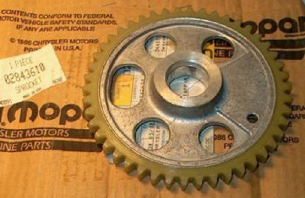

Probably a typo but, the timing CHAIN isn't plastic, the cam gear has plastic (aka nylon) teeth on a steel sprocket. That was done for noise reduction, although I've never heard a difference after replacing with all steel sprockets. Problem with the nylon is, especially after many many years, it'll not give any warning. the car will be running fine and then,,,,,,,,,,,,dead with no compression. Have had that experience twice in my life and they always break at the worst possible time and place.
HA! That makes a lot more sense!

Here is a picture of a plastic timing chain (plastic teeth on an aluminum hub).
By the way, they don't make 'em in plastic anymore (had too many problems with 'em).

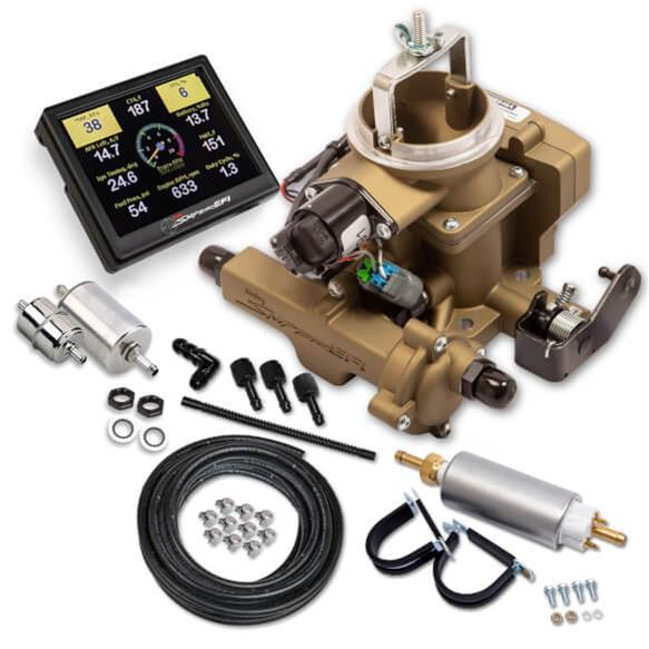

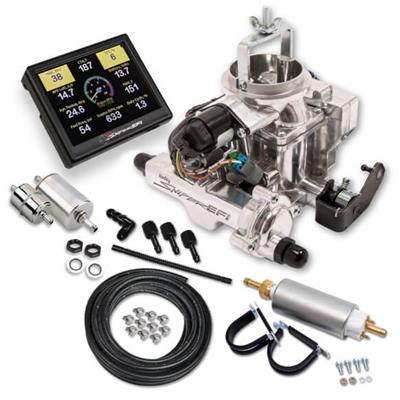

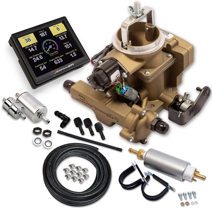

Holley Sniper makes a BBD replacement (but for a Jeep) Holley Sniper EFI 550-860K Holley Sniper EFI BBD Master Kit for Jeep CJ - Classic Gold . There are other members here using the Holley Sniper 4-bbl appearing F.I. Units. This one will require a small bit of linkage modification – but should work fine.

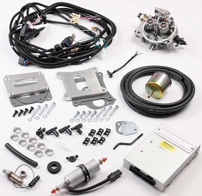

This kit will require a different air cleaner: #HD273 Chrysler 273 CID TBI Conversion Kit - Howell EFI Conversion & Wiring Harness Experts There are other choices out there too.

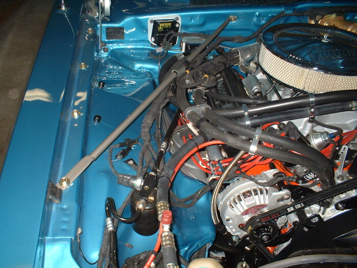

Your engine compartment could use a bit of cleaning but overall, in much better shape than mine is.

Your engine compartment doesn't look like anything that a wire brush and paint couldn't handle. Mine has a bit of surface rust, but very little. More, it is just thin worn paint and dirt. I really would prefer to have it painted along with the entire car instead of rattle canning it. Not that I have immediate plans to do either one. Ha, A/C is definitely NOT on my list of things to do. That is way beyond my skills, and I really don't think I would ever really need it, not being a daily driver. I actually don't even need the heater, but it does work - lol.

The Holley Sniper 550-860K lists at Summit for $1393.
The 550-858K lists for $1337:
In the questions section, someone said that it bolts directly to the "late '70's Super Six manifold". The only difference I can see between them is that the former is a gold color which doesn't matter to me. While expensive, if it truly made a significant difference in drivability, I might go for it.

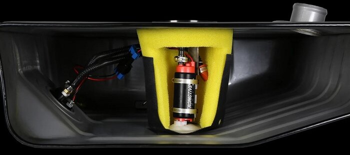

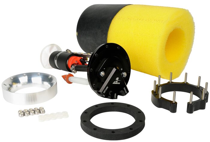

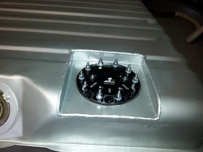

For what I have researched, I think this design is better – which is to put the electric fuel pump inside of the fuel tank – which keeps the pump cooler.
The Phantom - Aeromotive, Inc
This is a different version of same pump - but gives an idea on how it looks.
Note: the black outer part is a slosh cup. It prevents the fuel pump from sucking air on a hard brake or another maneuver that might allow the pump to suck air. The system that @Aspen500 mentions does the same thing but outside of the fuel tank.
I do not recommend cutting into or welding on a old fuel tank – so I got a new gas tank to work on. You never know what surprises lurk inside of a 43 year old fuel tank.

Having the pump inside the tank is always better but it requires more specialized skills (like leak free welding) and a new tank or, the old being boiled out if your city has a radiator shop that still does that (we're lucky and have Glen-Ray Radiators here). The type shown is the best way to go because of the reservoir around the pump motor so it's always submerged in the fuel, which keeps it cool. Also muffles the pump noise. The reservoir stays full with the return fuel directed into it.
