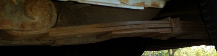

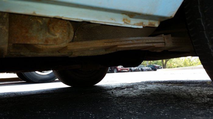

These pictures were taken a few minutes ago, from my 40k mile, pretty much 100% original ’77 wagon. The car has short tires one it (but can’t tell due to the shadows) – which are about 1½” shorter than OE size are (195/60R14 – I think) – so car sits about ¾” lower than it should be.
They came with car and I’m cheap and trying to wear them out before getting the correct size tires reinstalled.
This car does have the optional 5-leaf leaf springs for station wagons (some wagons came with 4-leaf’s).
In-my opinion, the ride height is not bad for a 40 year old car – but springs will be re-arched in next year or two.
The picture does show a “Figure S” shape to the leaf spring – due to weight and sagging, but not due to anything being bent or broke. Just normal sag from age.
A spring shop can get that back to where it needs to be in no time (but most likely I will re-arch them, myself).

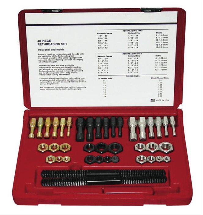

Before doing anything, it might help to purchase an SAE thread chaser/cleaner (which cleans threads – and not make new threads) set and clean the existing threads, first. The rear shackle threads fare worse for rust than the front spring hanger threads do, it seems.
Do the same for the Differential U-bolts.
Also to use some penetrating fluid (a couple of times), as well.
http://www.ebay.com/itm/Craftsman-Thread-Chaser-Cleaner-Steel-Includes-Storage-Case-Each-/391720415101?epid=1284613092&hash=item5b345b2f7d:g:slsAAOSw~AVYutmN
Note: there is a bunch of brands, different design and styles, etc. Which one you use doesn’t matter much.

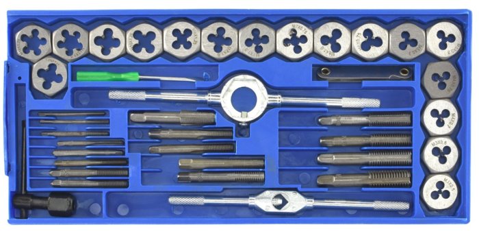

I don’t recommend using a tap and die set – for those are good for making new threads (only) – not for repairing or cleaning old threads.

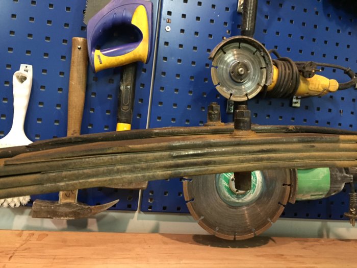

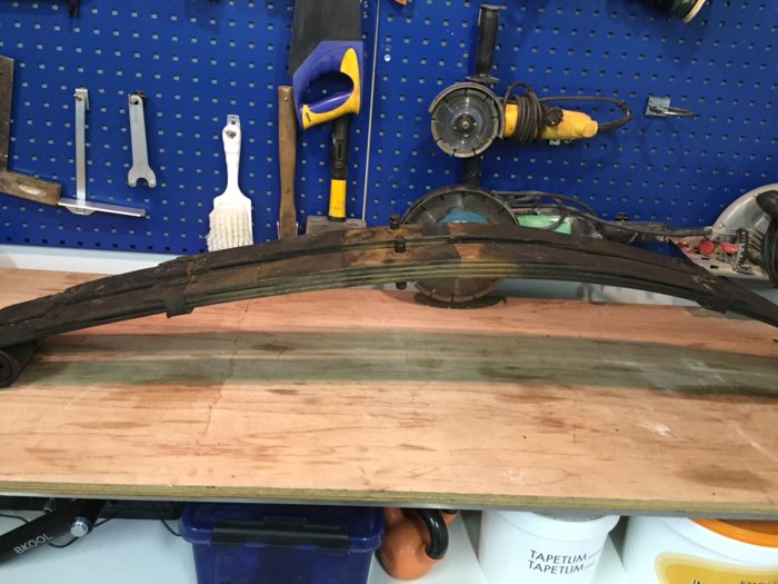

Got the springs off the car this morning without any problems. Have cleaned all the threads with a wirebrush and greased them.
Sure enough: The R side spring is depressed about 1 cm more when comparing heights along the L side. See picture. I am thinking to tell spring shop to set the L (good) side 2 cm higher and then make the R side match it.
Will this be ok for future use you think ?
