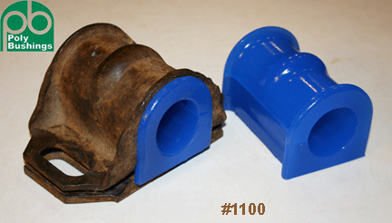

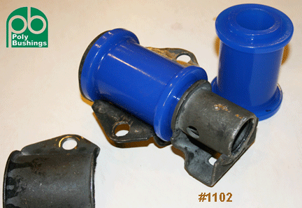

They offer some torsion bar bushings that others don't...and don't worry they arrive in black...I think they merely changed the color to make it show up better in the pictures...
Torsion Bar Bushings
Dodge/Chrysler/Plymouth
1976-1989 (see list below, left)
Replacement Bushings made from Polyurethane
Metal parts are not included!
#1100 Set includes the 2 center bushings. These are a hard polyurethane
to keep the torsion bar funtioning as it should. Includes the bushings
only, not the metal parts. You will re-use your metal parts. It does
include PolyLube. Made of high quality, suspension grade polyurethane. Part number PB1100
$49 Kit (Includes 2 center bushings and polylube)
Plus $7 Shipping (USA)
#1102 Set includes the 2 round, end isolator bushings. These are a soft
firm polyurethane to keep the torsion bar isolated. Includes the bushings
[FONT=Arial, Helvetica, sans-serif]These are also available in hard for race applications by special request.[/FONT] Part number PB1102
$69 Kit (Includes the 2 end bushings and polylube)
Getting Both Sets-Shipping on both sets is $11 - Priority Mail (USA)

The owner of poly bushings and myself got this project started. i sent him brand new moog bushing and torsion bar bushings with shells and he sent me back the harder racing bushings which are blue. yes i was the guinea pig and shelled out the cost for new stuff for him to make molds off of. those are actually my parts in the picture on his web site that are on my car. I don't remember his name right now, Maybe Pete? but what a great guy to deal with. I advertisted for him abit and showed his stuff to the guys on Moparchat.com also. I also put his website up in the Mopar parts system called Star Parts. But he makes alot of bushings for other vehicles as well. very talented at what he does and good guy to talk with on the phone. he didn't have the black ready yet when racing season started so i got the blue ones. maybe since they are the prototypes they'll be worth something some day. LOL

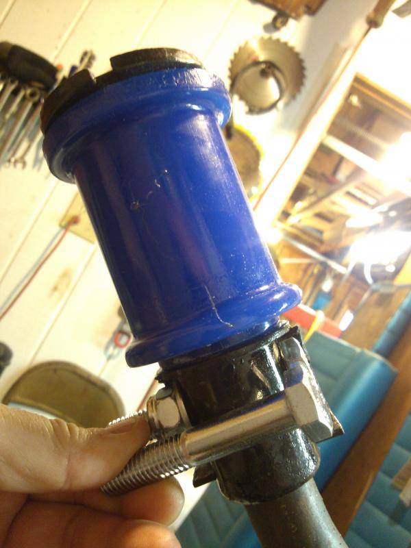

Just got a set in yesterday. The inners are black and the ends are the brite blue as in the top photos. Color is not a big deal for me.

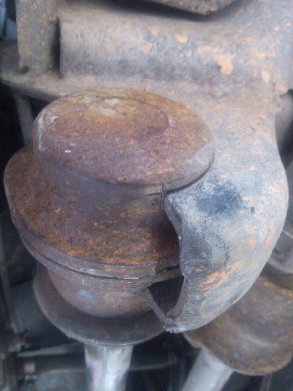

I am in the process of splitting the shells right now. And let me tell you its a right bugger, compared to GM parts I have done the same to.
You got two methods as I see it.
1. Drill out the four spot welds. Pick a bit that is about 1/8 wider than that ovoid shaped dimple that is the spot weld on the bottom. Use a quality drill and plan on sharpening it for every weld. Its hardened in that spot from the welding.
2. Use a thin cold chisel to spread the shell halves at the bolt slot. Then cut down through the groove you made with a thin cutting wheel in a small angle grinder, till you weaken the weld enough you can break it with the chisel. Hammer the parts back flat and grind up smooth any nastiness you made.
I did 1 first and found it slow and miserable. So I had a think and tried #2. You might think you are ruining the shell. and it comes out a bit scratched up, but its so much faster. Oh yea...it might not be obvious at first but you do have to grind off that cross rivet on the end and punch it out. then the whole assembly of the sway bar mount and bushing comes off the bar end. With a little persuasion. :)

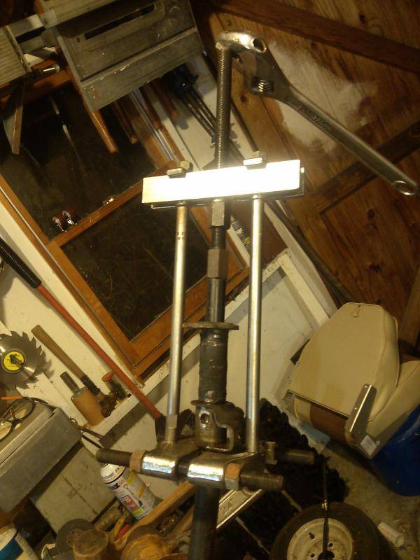

Even after drilling the rivet I had to use my heavy duty bearing splitter - puller to pull the bushing/sway bar mount tubes off the torsion bar. It was a hard pull even after the last little bit of rivet sheared off. I don't know how any one with out a puller like this would get these devils, that were never supposed to be removed, off the bar. Do not think you will just hammer them off the bar. :eusa_think:

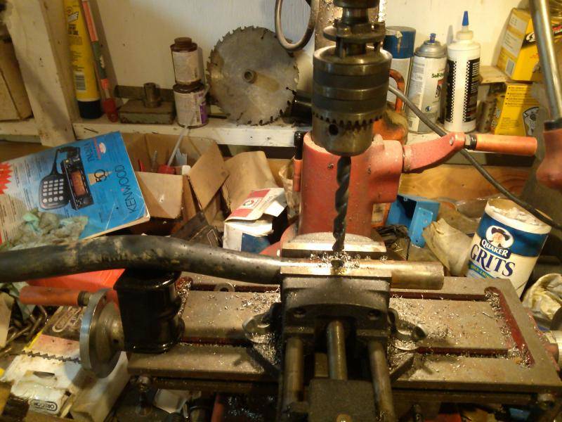

Drilling the rivet.
On this 2nd go round I didn't cut off the rivet head first. I jigged it up in my mill drill making sure it was square and level so I wouldn't drill into the bar. After center punching the rivet head I drilled up in three stages ending up with 7/16" which is shy of the slightly under 12mm hole in the bar. This left a shell that was easy to punch out. The 7/16" is under size enough that if you are off a taste you wont cut the shell holes or drill in to the bar. This pic is after drilling the rivet, here I am drilling the hole out a few 10ths of a mm to 12 mm. Because...

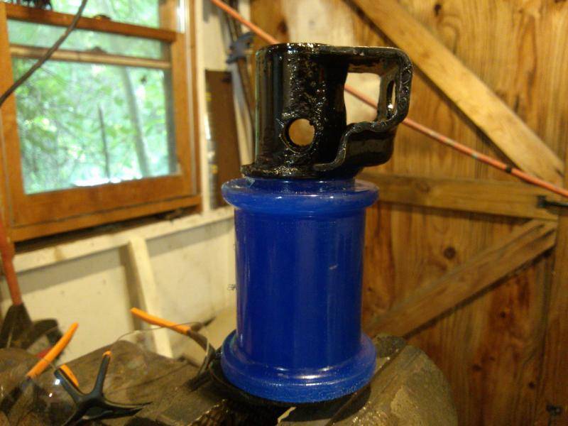

End bush ready to go.
Turns out the hole in the shells is just clearance for a 12mm bolt. So the bar hole had to go to 12mm. The 1st ends had to be pulled off. See above post. The 2nd just tapped off with a mallet. :confused3: go figure.
Bolt length.
I selected a 12mm bolt and washers that would put the most un-threaded shank into the bar. Tightened them to 55 ft-lbs.
I could have drilled out to 1/2" ...13mm but I didn't want to cut into a part like a torsion bar any more than necessary. I recommend at least a drill press to do this. It's tough free hand to drill accurately enough. So over sizing to 1/2" might be a back up plan if you have to when you cut the holes in the bar wonky.

The end bushing "holder" is actually two pieces. One long tube with the big end washer welded on and then the sway bar connector end, that slips over the longer tube. The whole shebang slips over the bar end, all the holes lining up.

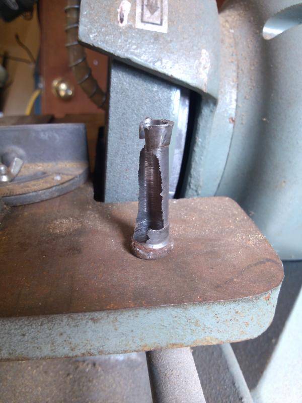

Here is why the book is just wrong on driving the rivets out.
When the factory assembled the bars to the tubes they used a great honking hydraulic press and squeezed the rivet shaft out into the slightly larger bore of the sleeves. That locked the two parts together nicely but complicates getting them apart. I found this drilled out rivet when I was cleaning up the shop.
