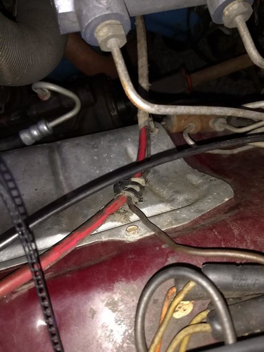

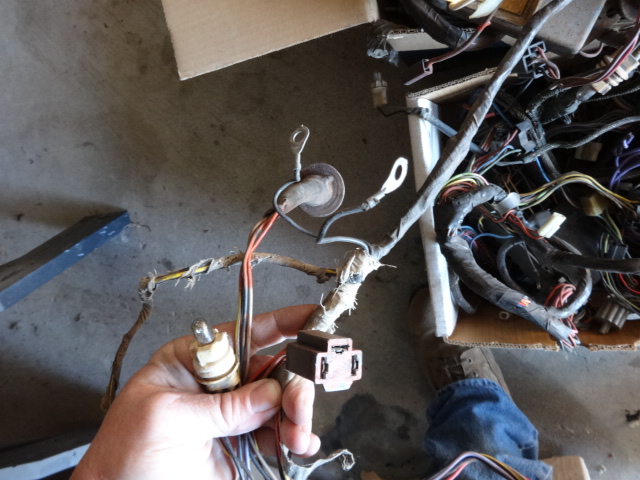

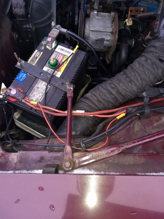

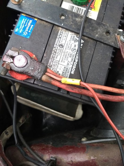

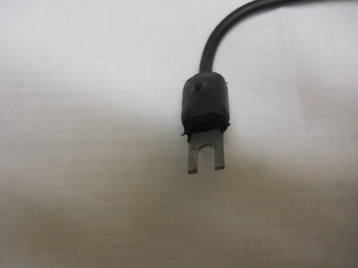

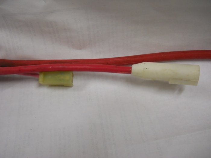

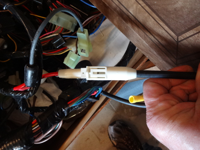

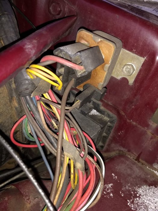

Here is what we have......seems like it is the same except for the relay end of the brown wire.....I should be able to splice in the plastic connector end....

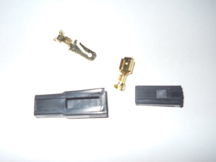

Our pink wire was apparently cut at some point and butt-connectored. Wouldnt mind changing that to a disconnect.....wonder if the plugs are available anywhere to match your cable?
My son measured it as best as he could in the car and got around 48"...so I would bet the 46" you got is correct.
My biggest concern was that larger white connector....looks the same to me......you??

white connector looks the same to me, you probably can use the old brown wire connector at the relay and just put in a new terminal end in it. or maybe a 76 starter relay would work

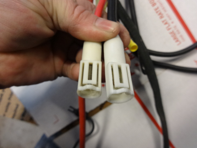

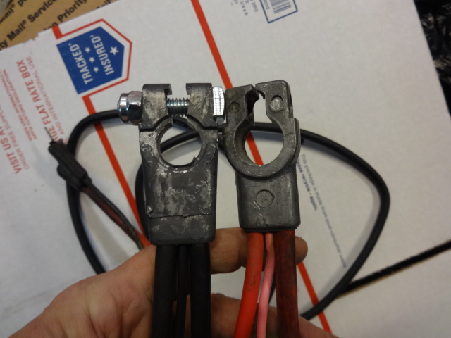

XfbodyX
Sep 9, 2015
1,713
489
Central US

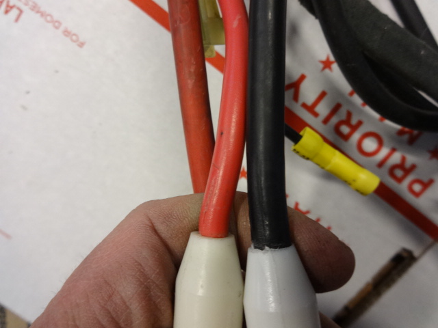

I got to bust on ya a bit here, you said, needs to be 100% reliable, dude its a 40 year old f body that would fry wires when new, no crash protection, air bags, im confused. :)

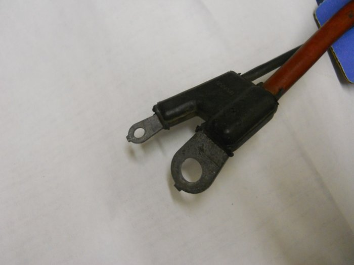

But really we all know china parts are hit and miss but as shown in the pics the repop actually is of good/better quality as they make replacements for even current rigs.
The batt connection is more HD, the white plug you mentioned concern about is dead on and even a heavier gauge wire and its not just the cover.
And I got to ask, why a repop neg. wire vs nos if 40 yr old nos is better, there are plenty of nos negs around.
But really I hope your son has a good safe trouble free school year.
I use NOS on my restored cars but repop on the others and no issues.

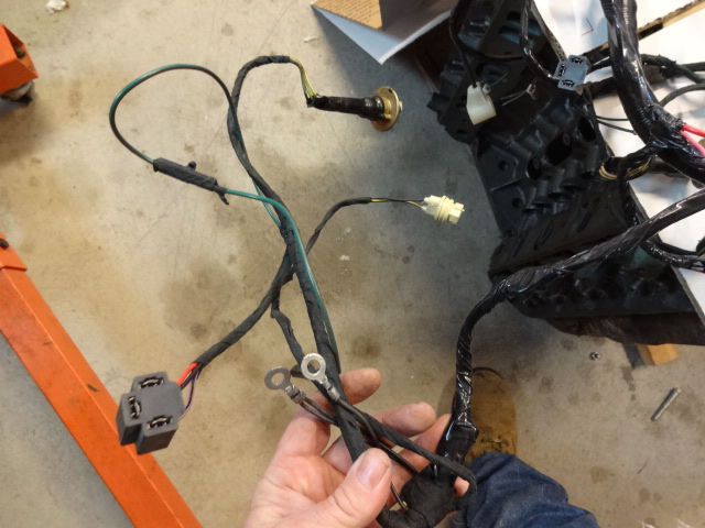

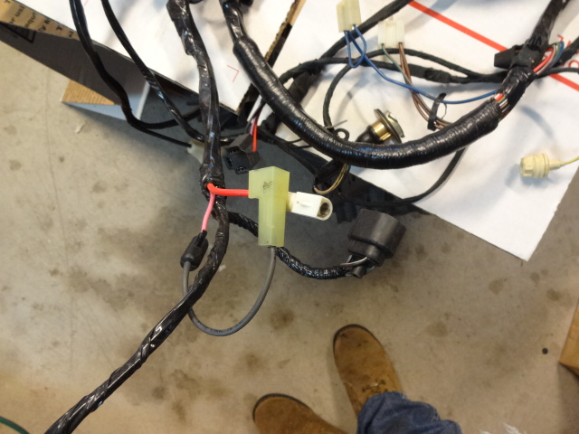

Volare77, Sorry to post this here, as I cant recall my login on the other fmj site but there is like five wire harnesses for our f-s. AC, Non AC, diff alt, ect.
A couple dont have the provision for the fender turn sigs.
In these pics of a nos, non turn sig, harness.
One side is just the headlight,marker/turn/inside fender turn, two grounds then up to the alt, other side headlight,marker/turn/inside fender turn, two grounds then up to the ign. box, and im forgetting the horn wire, thick green.
Ive boxes of used that I sep. mostly by ac/non ac the divide into fender blinkers and non.
These are all non fender ones in the pics. There too nasty to dig them all out and even harder in the cold.

In your pics you show a "thicker" black cable.....well, there is no way to know what size core is in that jacket....plenty of data out there to say that some aftermarket wires look thicker due to fatter insulation but have the same or even thinner cores. Cut them both in half and compare cores for a true comparison. Depending on what vendor you pick for these parts, they may be as good as or worse than OEM/NOS. I have very seldom seen aftermarket common replacement parts that were engineered BETTER than originals......not including PERFORMANCE aftermarket parts that is.
The "bigger" white plug doesnt help me as I am using the existing original second half which would be smaller if what you show holds true......if they do connect ok (and that would be a major concern), the extra size for the larger white half doesnt net anything. And the gamble is that it WONT fit.

Im glad im in the shop today, your killin me here. Im hard headed too and like and use nos junk all I can but in some instances I will buy and inspect a repop. Too bad we cant get rear quarters, from anyplace.
Look at the pick, the plug is proper male/female fit into a NOS wire harness I just didnt want to click it in, but the pic I posted did make them look a bit different in size for some reason.
I cut one long ago to see if I was getting miffed but its a legit cable.
