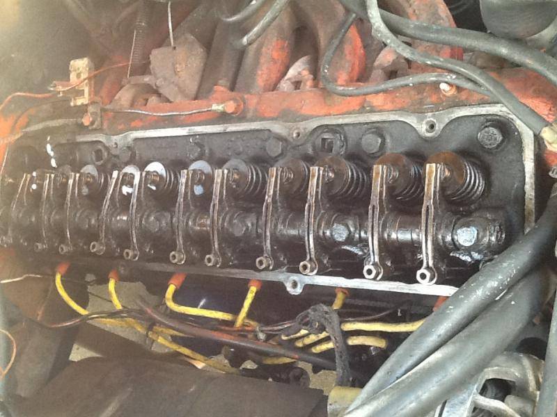

After 2 hrs of careful tweaking I was happy! Still good w/540k miles.

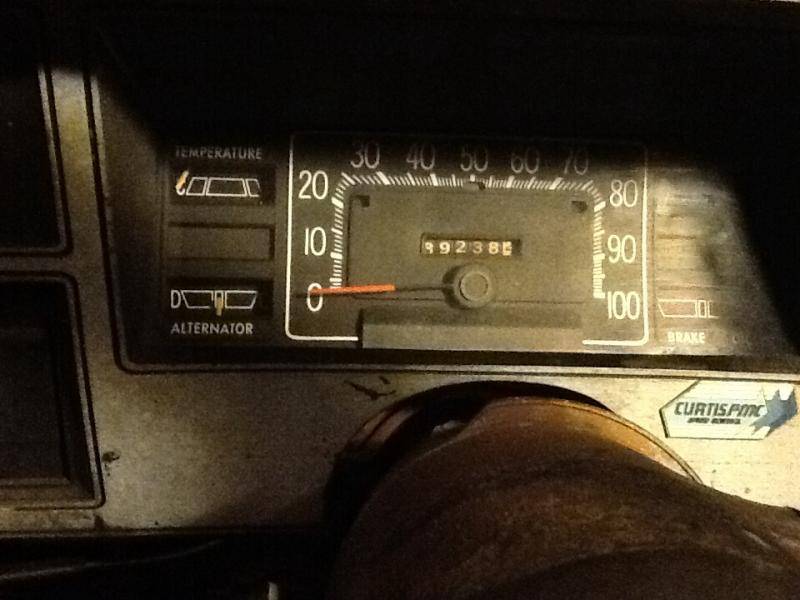

Yeah, 539,238 actual but that number is expected to continue climing slowly. I only commute 1.1miles to work. . .so... there was to be a video of the valve train in action but I didnt know how to post this from my iPad. Sorry.

There are only a handful of parts that have been (replaced) all stock - still running the original alternator, radiator and transmission - differential - engine has not been *apart* but far enough to install a new cam chain at around 500k. Valves were supposed to be adjusted about quarterly if I remember right @20,000 miles but it usually held well enough to get me to twice a year. The poor thing has seen almost as much time off-roading as highway. Pulls great and only been stuck twice. Pulled out a new cj-7 buried in sugar sand cause the kid that bought it didn't know how to lock the hubs in..... after I sealed up the vent on the distributor, did well in deep water too. Used to just head to the woods for fun on the weekends.... :) Wagon so room for the whole family!

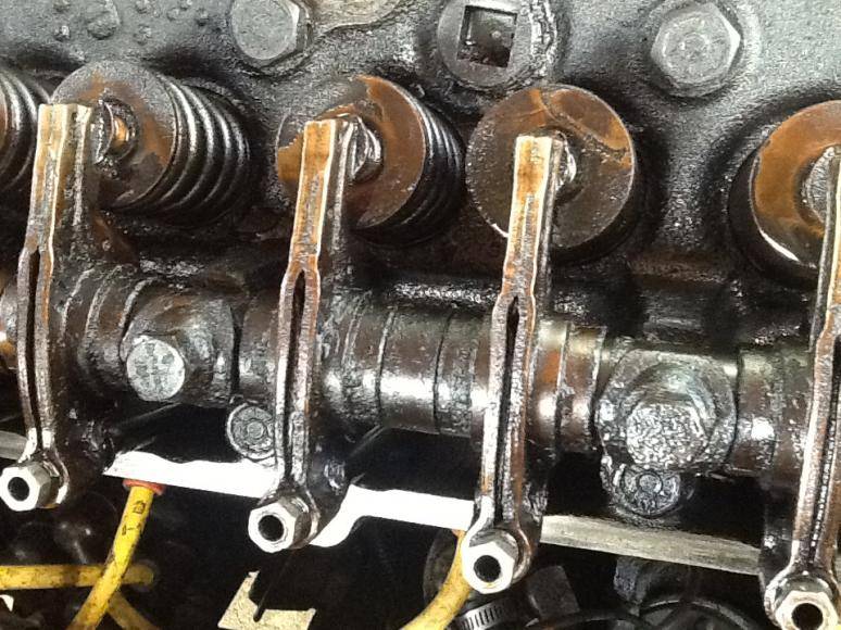

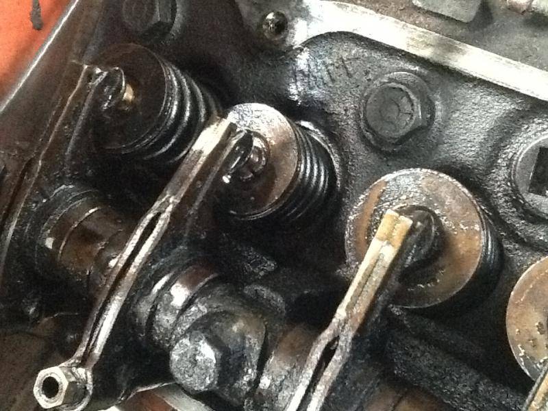

Not too shabby for 500+ miles huh. I have number 6 (intake) isn't pumping too much oil. The rest are splashing it everywhere... any thoughts on how to unplug it with out tearing it all apart? Tried carb cleaner and compressed air, no joy...

I meant like bailing wire. should be able to run it all the way through your oil passages to clear up any blockages. I don't think compressed air would work on a partial one, no way to build pressure unless it's completely closed off

You know I didn't try in an unplugged one, I was thinking the hole didn't line up till the rocker was in up/down position and I did try a very small spark plug gapping wire that had been straightened out but not in an unplugged one. I guess the top comes back off again (hopefully) this weekend, and I can always take the pushrod out to move it further up.... down would be another matter. I also need to flush out the carbon chunks that got blown in the pan when I was in there doing the adjustments. . .
