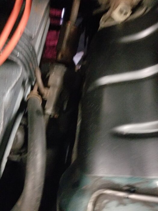

Need some assistance sourcing the proper pressure side power steering line.
This winter I did the very fun /6 to 360 swap and ran into a few unforeseen challenges.
One was with the power steering pump line as you can see from the picture below. I bent it away from the exhaust manifold as much as I dare.....but it's not right.
I have scanned through pictures on rock auto to find a line that takes a right turn instead of a left out of the pump but I found them inconclusive
Anyone with knowledge of what would be the best line to solve me issues?

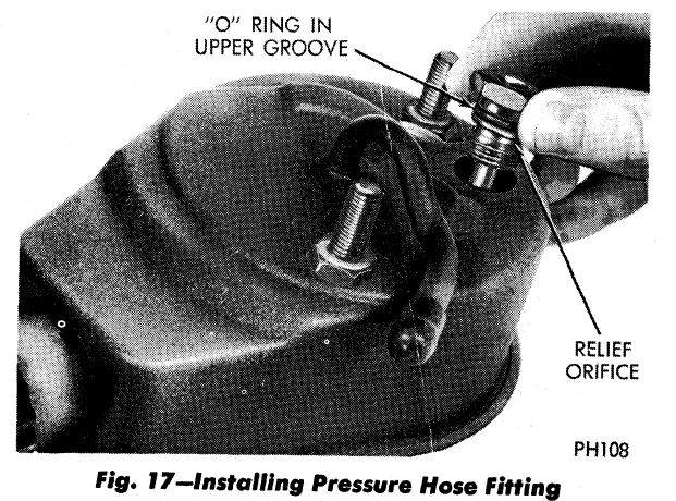

There is a "Metric" and an older (non-Metric) P/S pumps used on FMJ's - and I'm not sure what the break year is. I will "guess" the break year is '79, but don't quote me on that.
The Metric pumps do use metric fasteners where as the older pumps do not - so if a person can remove a pump bracket bolt (or nut) and can find out if it is indeed Metric (or not) you can know for sure.
The reason I bring this up is the P/S pressure hose is DIFFERENT, where it attaches to the P/S pump. The return hose is the same size.
The newer P/S pump fitting seams to be a better design (flare fitting vs. an O-ring) to me - but that could be debated between people.
If you get the wrong hose and have some old Saginaw P/S pumps laying around, you can change the pump fitting (metric (flare) to non-metric (O-ring)) by un-screwing the large fitting from the pump and re-attaching. Just be prepared for a small fluid mess and also make sure the valve & its spring, just behind that fitting, doesn't walk off on you. Both will generally stay in-place with fitting removal/replacement - but your experience may vary.
Now with that said, the P/S pressure hoses for all Chrysler passenger cars (not trucks or vans), from '72-89 will interchange - providing you have the same Saginaw pump fitting. With that said, there are some minor differences on how hoses are bent - to avoid things - but I haven't ran across any hose not being interchangeable - and some versions that might be more desirable. I have even seen 3-4 brands of hoses, for same vehicle, that are all bent differently - but will all still work fine
If a person has an odd setup (big block, or headers, or ...) sometimes finding a different brand hose will work (Gates vs. ...).
The important parts are to make sure the pressure has the same style for pump fitting (flare fitting vs. O-ring) and it not to leak upon install (which can be a big factor for some Chinese parts...).
Here is the large fitting for the Saginaw pump:
I don't have any pictures of the flare vs. O-ring hose fittings. The O-ring shown above is not the O-ring used on the hose.
