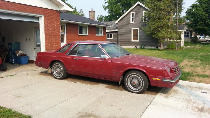

So I have decided the Mirada needs to come out of storage for some TLC. Here's the rub... it's been sitting for about 6 years and was put away a bit hastily when young and dumb. :eusa_wall:
While the body and such appears to be sound and rust free, there is likely a list of engine/fuel removal issues that will need to be sorted. I assumed as much. Fortunately a 318 doesn't require a degree in mechanical cryptography. Worst case is swapping in another 318 or 340... right? :eusa_eh:
The worst part is that some mice seem to have gotten in. I shoulda mothballed the hell out of it. The year before I stored for winter after an oiling and had good luck. Not this time. There is a bad smell and at least one dead one on the floor. It's foul. I assume this will be my biggest hurdle. I am actively hitting google, trying to find what I can, but am curious what the J Body crowd has to say about my stupidity. I figure since I'm new a bit of hazing is in order.
After I live down the shame, I've gotta roll up my sleeves... where do I start and how? Thanks in advance.

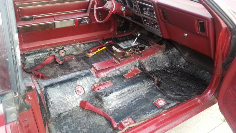

I've spent some time removing junk and the interior from the car. I am amazed that after the seats are out, there aren't that many screws holding the interior there. Also found some prize spare parts from the factory when I lifted the carpet.
It was probably overkill to pull it all but I wanted to be safe. The front seats are fine, just need a vacuum and shampoo. The rear seat bottom is perfect as well. The part they got into was the foam on one spot of the rear seat where they made a nice little nest. Was easy to clean out but now am left pondering how to deal with it. Will likely find some foam in a similar density and make a patch. Simple enough.
Need a Radiator and Brakes for sure. Tires too. I was expecting it. My friend has 16" tires he was gonna give me but then I'd need 16" rims. My preferred option is finding 5on5 or 10spoke cmx wheels and putting rubber on those. Reality is i Wil probably get tires for the steels and caps i have now, and when I find wheels swapping the tires over. In that case, what size tires should I look out for??

Here's a photo of the interior after a few hours of hard work yesterday:

Your paint isn't likely to be damaged any more than it has been by being "unloved" for so long. Just use a Ph-neutral car soap (any brand of "car wash") and use the two-bucket method for washing: A bucket for your soap and water, and a rinse bucket. Get the car wet, apply soapy water with a wash-mitt, rinse the mitt in the rinse bucket, repeat. Apply a wax after your wash. I'm not a wax snob, any will do. For now, just start with good ole' Turtle wax, you'll be amazed. If you have time, using a polishing compound before the wax job will remove even more oxidation. Just be easy on the polishing compound -- it's easy to polish the paint clean away, especially on the corners. A little goes a long way (product & pressure!)

Your car appears to be quite clean, both under the hood and inside. It should be pretty easy to bring her back to life. Since you've taken the trouble to pull the carpets, you might consider replacing with new. They're on ebay for about $100, and will really dress up the interior. Again, since you have the flooring pulled out, adding Dynamat would really quiet the car up -- but that does cost quite a bit of money. I get the sense you're on a bit of a budget: Shampoo the carpets before reinstalling -- much easier, and you can make sure they are dry before reinstalling. Keep us informed!
