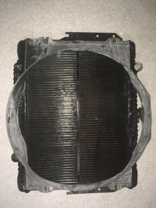

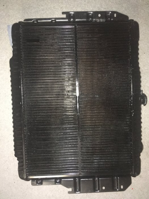

Here is my rad
I’m not sure what measurements you need specifically but I’ll offer up this:
Actual core measurements
26x18.5”
Top of the tank to the bottom of the tank at its tallest excluding the filler
22.75”
Width of tanks just shy of 26.5” but with the bracing 27.5”
Total mounting width 30.5”
Mounting holes width 29”
Mounting slot to top hole 8.75”
Hope this helps, sorry about terminology or lack thereof lol

Oh I forgot to add
This was from an 87 with 318 and is the same one I was able to get in my 76 Dart when I put a 318 into it. it was a squeeze for sure.
I have this one just in case I boogered up the one I used in the Dart because it was in and out and back in and back out lol

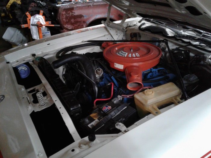

Alot of good useful combined info here. I will add a little bit to what Bud posted.
Ive used almost any rad. in a F within practical limits and have found the only real limits is the distance between the frame rails and the distance from the base to the top of the core support.
One of the best things of being in the fmj world is we can use nearly any drive line configuration from the muscle car era to far past it.
Maybe Bud can articulate a bit further on the strap aspect as he mentioned as I see it as useful if one was doing a proper resto or conversion and myself have never thought of it simply because for myself I never found it necessary but now im wondering what I might of done if I had of done it...hmm.
With the F-s (at least early ones, 76-77) having two core supports, ac and non ac and to further backup the use of the older radiators if we look at the early 76-s they use the older type a body rad. vs the long slender that the F-s went to later and used in the M and J cars.
Here are a few examples in the pics. One beater I have has a early 70-s (74) BB (400) B body rad, I dont recall the PN but its actually the max airflow unit for a BB ac car. Yes, the core does overlap the non ac core support but factually causes no issues and on the reverse side still gets full effect from the oem shroud.
Its a bit ironic that so many who have seen this car in person have never caught it because it looks so factory because it utilizes oem parts, just a bit older. Only a few FMJ guys have ever noticed and said "Where did I get the BFR" at.

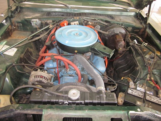

The second pic I robbed from a current ebay listing of a BB 440 RR, but was a 400 car and the lazy F--- dont even have a shroud on it asking 29K Canadian. But its the same unit I have.
I now have a proper mopar hose on it but in this pic its got a flex hose.

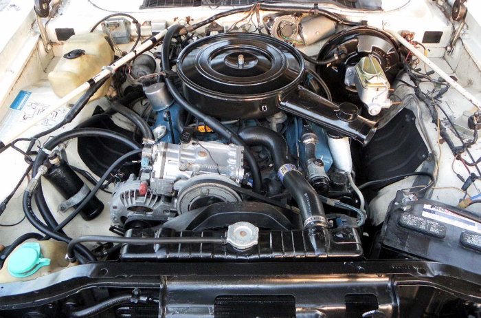

The third and fourth pic shows the early 76 F-s with oem correct radiators and you can see they are not even the full width of the core support opening and still the older design.
