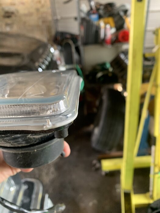

I attempted something like this last year on my 5th Ave. Also using some Ebay led 4x6 lights. The lens/housing halves came sealed together with a seam about 1/4” thick all the way around on all 4 sides making the headlights dimensions closer to 4.5”x6.5”. Couldn’t get the trim ring around them or get them into the bezels. I hope you have better luck with what you ordered.

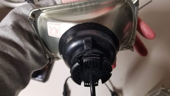

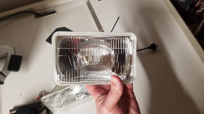

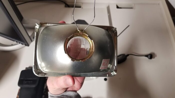

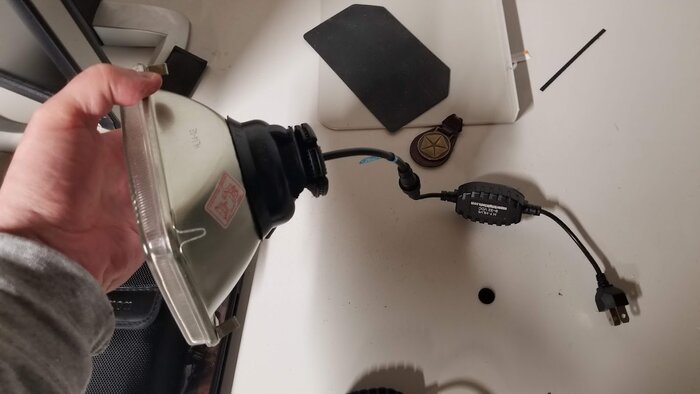

I used 4x6 to H4 conversion housings and used H4 to LED conversion bulbs. Fit good.
