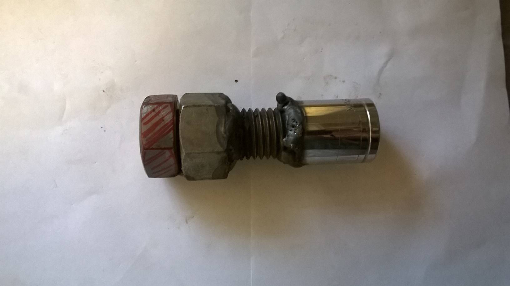

You will need a torque wrench, Loctite, and a dial indicator with stand. The ring gear bolts are left hand threaded. The hardest part will be setting the backlash. I made an adjuster tool for the bearings by grinding the head of a large bolt to fit and welded a 1/2' drive socket to it. a simple spanner could be made from some round stock, or a large pin spanner works if you can find one in a size that is close.
80mirada
Sep 3, 2012
1,581
629
Wisconsin, Fort Atkinson
My bearing adjuster tool was a 1 1/2' bolt that I ground the sides down to 1.4-1.42" (36.1mm). I added a nut under the head to act as a stop to keep it from sliding through the adjuster, and welded a 15/16" 1/2" drive socket.
If you can find one, a 36mm headed bolt would be even better

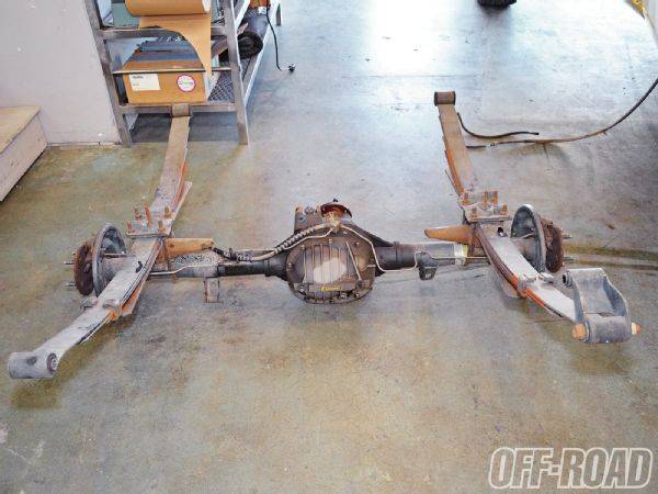

Nit noid question. If you're replacing the rear end and springs, isn't it easier to remove the old rearend/springs as one unit?
Bruceynz
Jan 10, 2015
1,802
200
South Island New Zealand
My rear end is a 7.25" I am upgrading the car to the 360 mild performance, I have an open 8.25" rear end to bolt in, but before I bolt it in it is easier to do all the work now well it is out of the car.
aspen77rt
Jul 25, 2011
381
49
Shelton, WA
Ill be doing the same in a few months. 7.25/springs will be coming out. 8.25 and New epso 5 leaf fmj packs will be going in. It would seem easier to just remove the old 7 1/4 and old springs as one unit if you're replacing everything. Once the brake lines and other stuff are disconnected, it's only six bolts per side to remove the rearend/springs as a unit. Like the pic for example.
