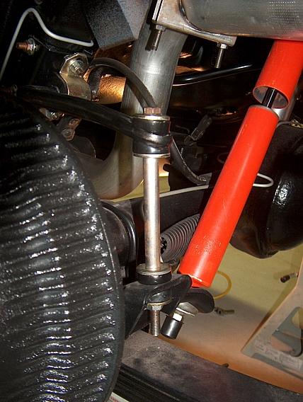

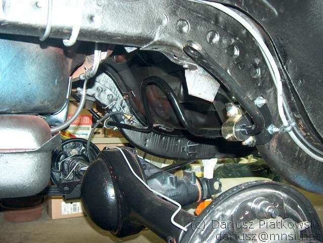

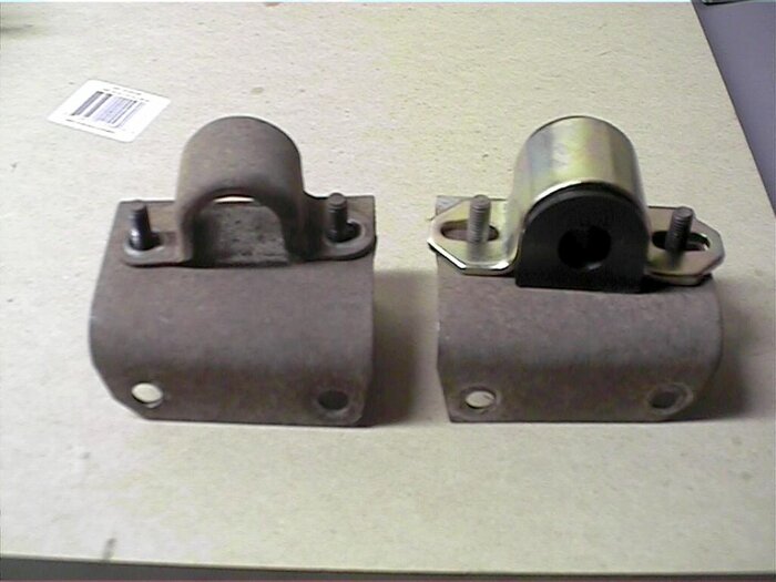

Here are a few pics:
1) cross shot of how the bar mounts up to the frame rails, note that while I am using the factory frame rail brackets, the bushing retaining clamps are aftermarket
2) and this is what the bar end, where the end links are located, looks like
3) the last one is a side-by-side comparison of the factory bushing clamp and the aftermarket one I'm using
