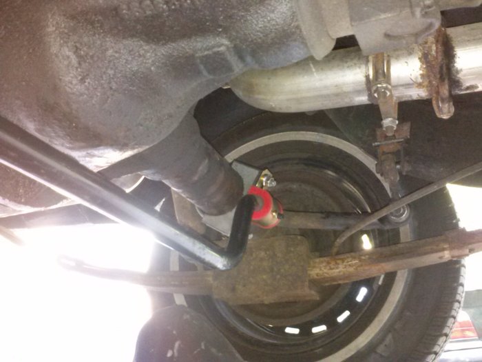

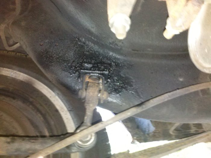

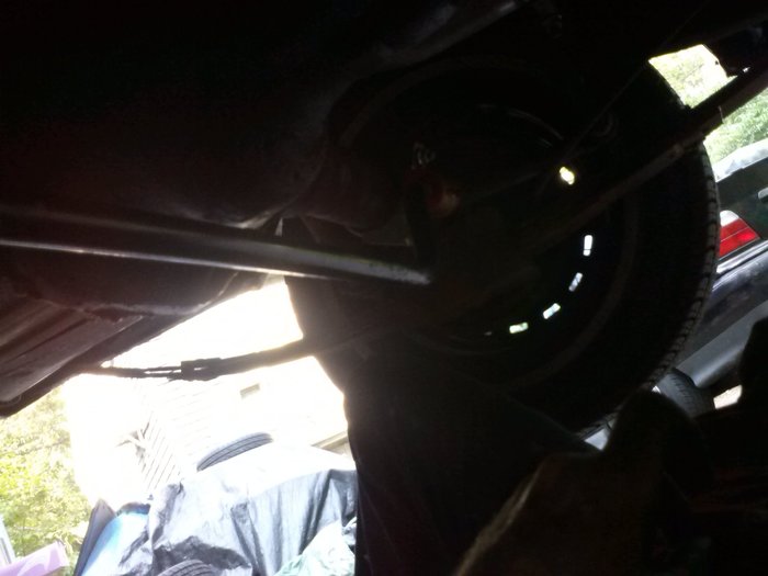

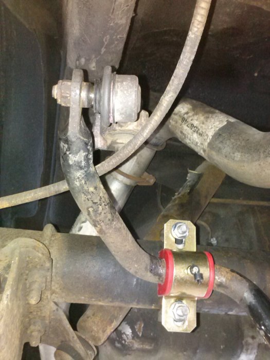

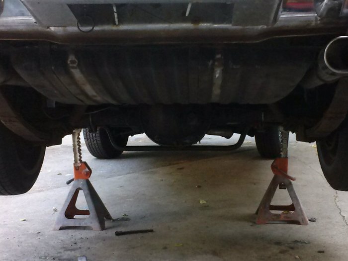

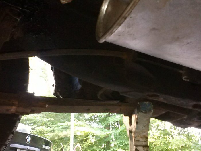

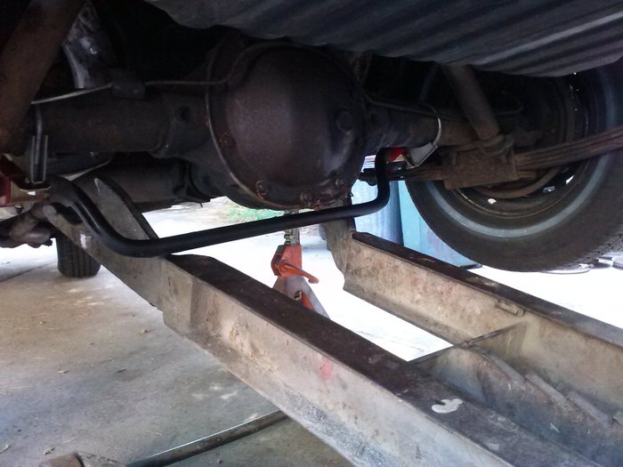

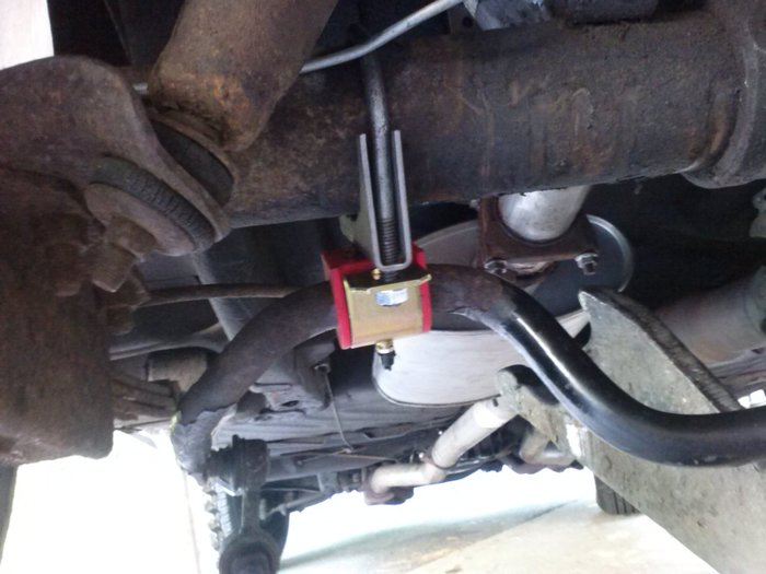

This weekend I put a rear sway bar under my Lebaron. The funny thing is it is the front sway bar from a 91 BMW 325 that my son was paerting out. It took less then 2 hours to do including getting new bushings. It seems to be ok so far and made a big difference. The bar is 22 mm (7/8). If any one is interested i did take pictures of what I did.

X3. That would be cool to see and maybe help others out who can't find a M body bar.

I would also like to see how you bolted it on,post some pics

Sorry but I am still trying to figure this picture stuff out. My son said this is all I had to do but it doesn't seem right to me. Sorry if it is wrong and maybe someone will tell a old guy what happened and how to fix it.
BTW appraently the sway bars have no value at all as they do not go bad and the BMW guys all update their stuff to M. I will be glad to answer any questions.
