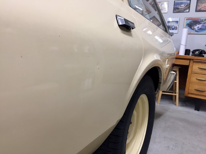

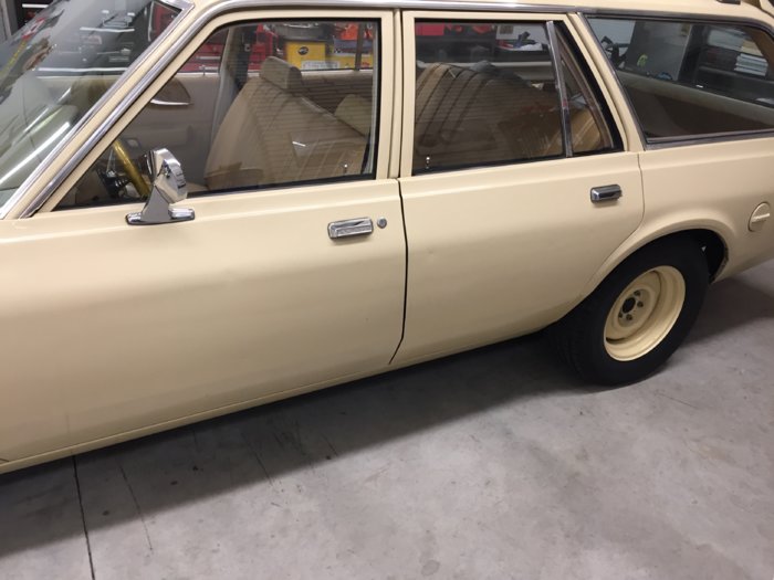

OY has black vinyl moldings attached only with adhesive. It is starting to come off in a few places, so I don't think it would take much to remove it completely. My concern is whether the paint will be a shade darker due to fading from the desert sun for 40 years. I suspect that it is original Mopar molding, as I have seen the same type on several other F's. Any pics of the entire side with the molding removed yet Raff?
Greetings OY, here is couple of pics with the molding removed. The area where the trim was is barley noticeable. You can feel the difference in the paint when you run your hand over it. Buffing the paint should take care of that.

Heat gun on low and the trim peeled right off. I just used a plastic scraper to give it a little nudge. All of the residue came off with the trim.
