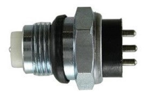

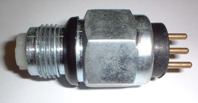

1,422
575
I haven't had problem with the aftermarket ones but make sure they plug in and the right one and work before you put it in.
The plugs look the same but the plug for one with a long hex body usually won't connect to one with a short hex body. That's the only problem I've run into.
If it is the switch, try to find a NOS or a used part if possible. The repops (ie: China) are not that good.
They make a short 3-wire and a long 3-wire NSS (Neutral Safety Switch). They will both fully interchange (if from a rear wheel/four wheel drive vehicle).
The top one came out in '68 (I think) and was superceded with the lower one during the FMJ years. My '77 has the long version and my '86, the Short one.
The lower one was used well into the '90's
Note: I will caution to anyone who hears me. Be very careful removing, moving, transporting, or installing a Chrysler transmission - because that switch (the NSS) is very easy to damage. Wait, scratch that, is EXTREMELY EASY to damage and is/are most likely thing I see is that switch damaged after some like of work around it, or transportation of a transmission (even accidentally kicking a transmission well hidden under the work bench . . .). I even got to the point of removing the NSS before removing a transmission (taping it to the tailhousing) and the last thing to install after an install.
I can also say that I have damaged my share of 'em, as well.
Also make note of the direction of the seal. Both versions above are using the proper usage of the seal.
Edit: there is also a version that looks close to the short NSS - but for the front wheel drive cars. I have heard the 3-wire electrical connector will not plug in correctly on some of them.
