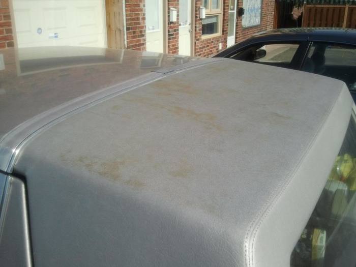

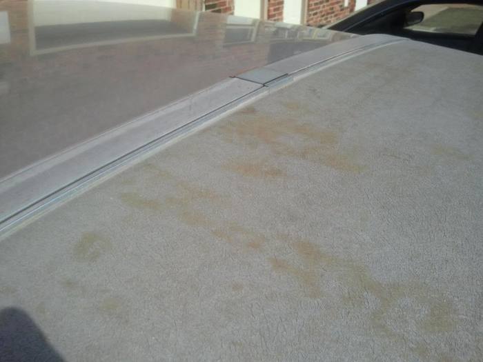

It appears the color (finish) on my Fifth's vinyl roof is leaving.
Can I paint this with vinyl paint to try to save it?
Or am I rapidly approaching new roof time?

You can repaint it. Clean it very well with soap & water, rinse it, and allow it to dry. Obviously, you're going to want to mask off anything you don't want sprayed. I would suggest SEM products if you can get them. They work very well and come in rattle cans. Use their vinyl & leather prep first for best results, then spray on some fresh color.
Excellent!
Thank you Sir.

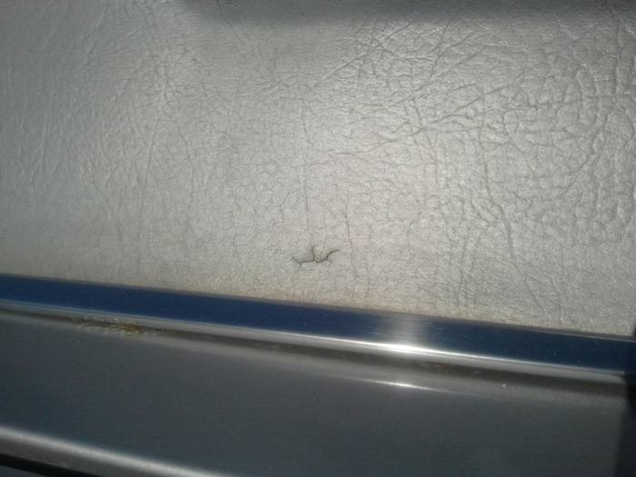

Clear silicone and a bondo spreader. There's not much else you can do for those, but it should slow them down a little.

For repairs, go to your local school bus garage. They have a vinyl that looks like Elmer's Glue, spreads with a spatula, heat with a heat gun, but before it completely sets, use the grain pattern sheet to "texture" the vinyl. Finish heat curing the vinyl, then paint with vinyl dye. Vinyl dye & paint won't stick to silicone. We used the stuff on seat repairs everyday until Ohio decided that no more repairing seats, replace the seat cover.
Thanks Larry....that's a cool idea.
I'll see if I can find a place up here and see what they say.

As far as protecting a painted vinyl roof....any ideas?
I need something to protect it without trashing the vinyl paint...

I've just continued to use the 303 on vinyl after recoloring it. The SEM stuff is more of a dye than a paint, particularly if you use their preparation products (cleaner and prep). It helps it soak in a little and really adhere.
