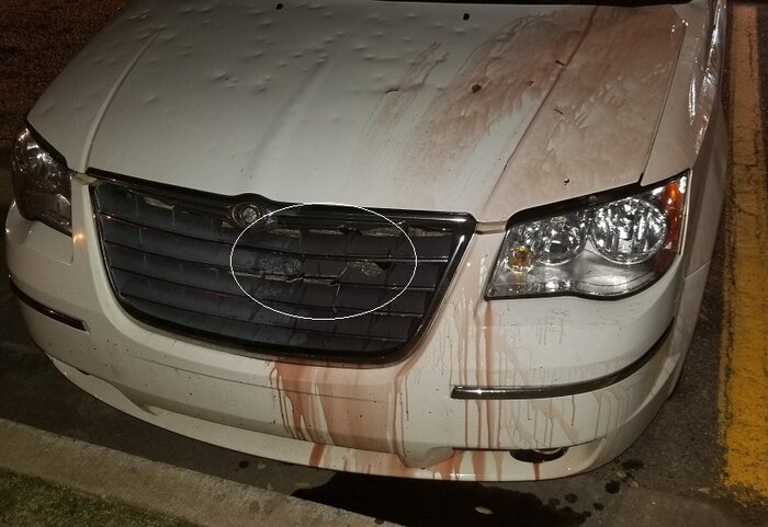

I visited my parents the weekend before thanksgiving (Nov 21), and on way back home, I was driving at night on a recently opened turnpike. I was going 80 MPH (the posted speed limit) with no-one around me, and out of the blue, a small item appeared from the sky and hit my minivan. I first thought it was a small box that squished into a bigger box. I kept going - then my windshield started to get smudged up.
I pulled off the turnpike and noticed van wasn't pulling itself (transmission slipping).
At first glance, it looks like blood - but it is transmission fluid.
There was duck feathers stick in the (now broken) grill. There is also a hole in my A/C condenser/transmission cooler (combo part).
(Pay no attention to the hail dents).
I was 17 miles from home and I ended up going through almost 4 gallons of transmission fluid just to get home.
If that duck hit a bit higher, I'm sure it would have gone through the windshield.

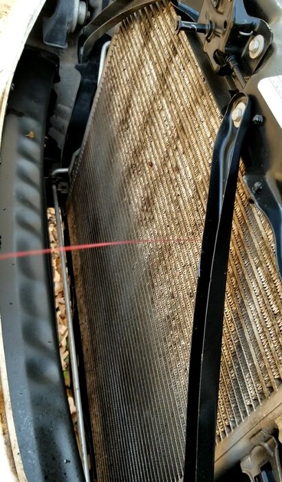

I took a picture of the oil leak, after I removed the grill:

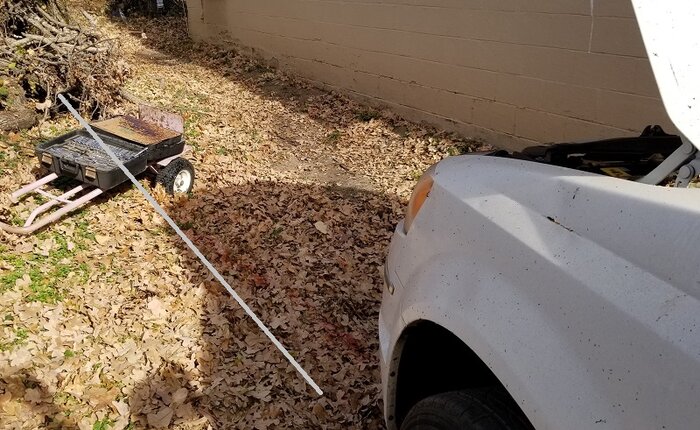

I tried to take a video of leak, once I could see it (grill removed), but transmission ran out of fluid during the video (by the time I started vehicle, got out to video it). This is a screen print of the video.
The gray line indicates a fluid spray pattern, but is hard to tell in the leaves.

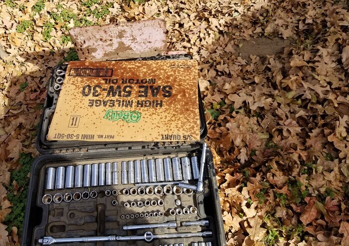

My open tool box - after engine ran for maybe 3 seconds before running out of ATF. The cardboard is only used for "anti-rattle" during transport.
