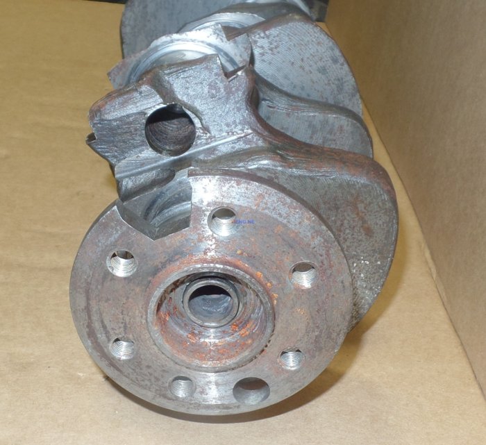

Chrysler drilled the back side of crankshafts for a pilot bushing – which the manual transmission input shaft slides into/rides on.
Back in the ‘60’s, most all crankshafts were drilled – but only manual transmission cars, had bushings installed.
Crank with pilot bushing.

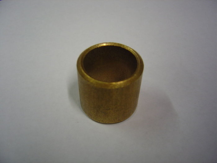

Bronze pilot bushing.

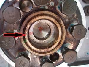

In the ‘70’s, only manual transmission cars, had the hole drilled. Automatic cars looked like this:
Some random picture I swiped from internet. Not sure what this is from - but example still applies.

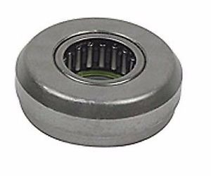

In the ‘90’s, Chrysler stopped using the bushing and started to use a bearing, instead. The bearing is the better way to go – but unless the crankshaft is drilled – there is nowhere for the input shaft to go.
If you are going to install any Chrysler engine into a car that has a manual transmission (car or truck) – you always need to check if crankshaft was drilled.
If so, great. The next step is to see if a bushing was installed.
It a bushing was installed – then just use it.
Do not use both a bushing and a bearing. If no bushing was installed – then use a pilot bearing.

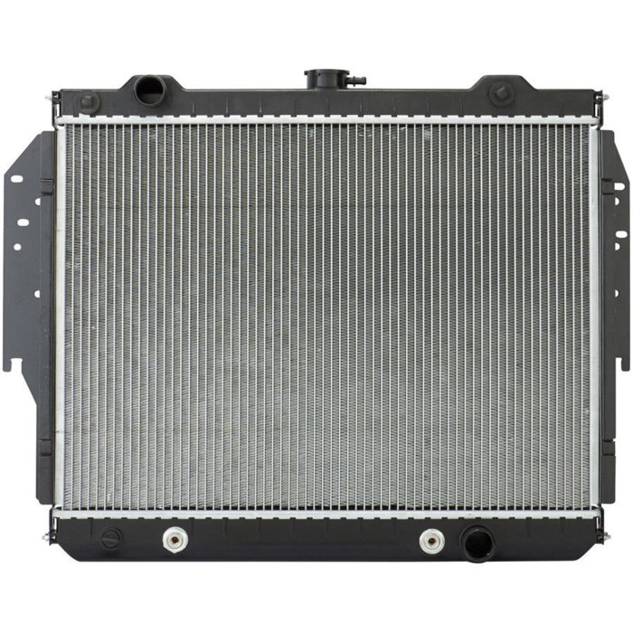

I do not remember the brand name but the part number for above part is CU500 (which got stuck in my brain). This an aftermarket aluminum that does fit an FMJ. There are still a number of companies making new radiators for our cars – but, as far as I can tell, they are all aluminum now.
Aluminum is reported to be more thermo-efficient than brass is – so even though it looks different it might even work better in some conditions.
’70 and up Small blocks (until the Magnum engine appeared) will all have the lower neck on passenger side.
All FMJ body and most all other Chrysler products with small blocks, the upper neck is on driver’s side (’70 and up). Some early cars and pickups without A/C the Upper neck is on passenger side – which is not a problem if not using A/C (just get the upper hose for that particular model).
Any ’76-89 FMJ-body V8 radiator that is 26” wide will work (providing the body plates have been switched out or existing plates have been cut out and new holes drilled).
Any year Dodge 26” brass radiator “can” fit – but bolt holes will not be in correct location and may require a different fan shroud (IE: get the fan shroud at same time as radiator – which you may need anyway).

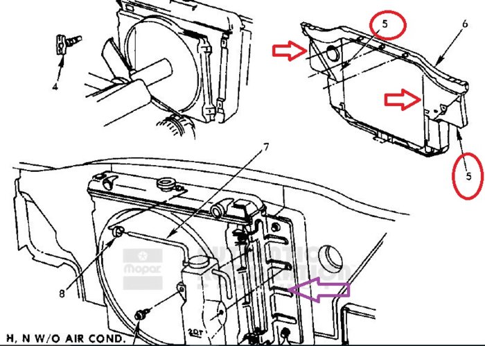

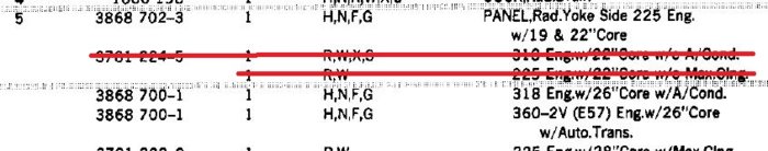

This picture shows the core support plates (item number 5) which are different from 26” and 22/18” radiators.
The plates are spot welded in – and not sure how involved of a job they are to replace.
