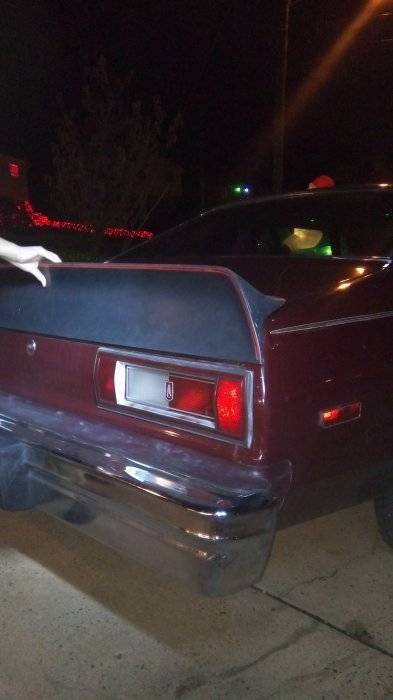

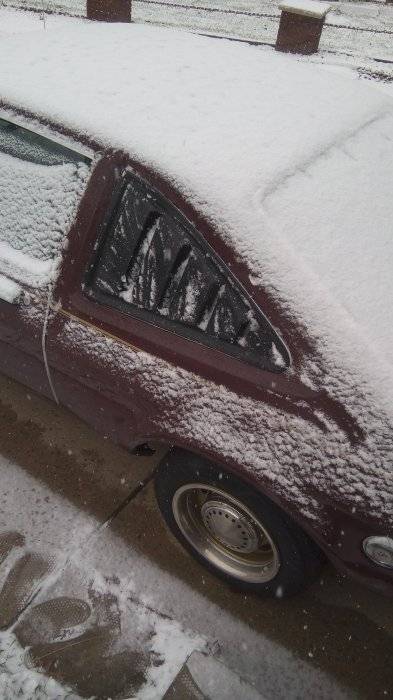

I have a duck tail spoiler (I think) for my '80 Volaré. It is black right now with two red stripes on the rearward outer edge. I'm thinking about painting it body color (Barron Red) or taking it to flat black, to match my side window louvres. If I take it to body color, I would want to take the louvres to body as well, but the paint on the car is faded, or "dead," and it could be a challenge to find paint to match it.
Side note...
Found pin hole in the left rear quarter, with rust on most panels, so it will have to get body work done eventually, but hopefully not soon. Want to get color idea b\c I'm taking body shop now, and have no where else to do it right now. Want it out of the way.
Thoughts anyone?

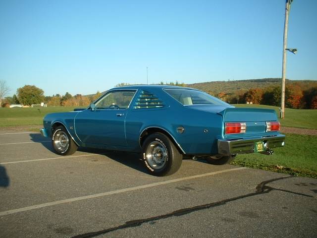

I prefer all one color (like Aspen500's car) – but some do like the opposing colors.

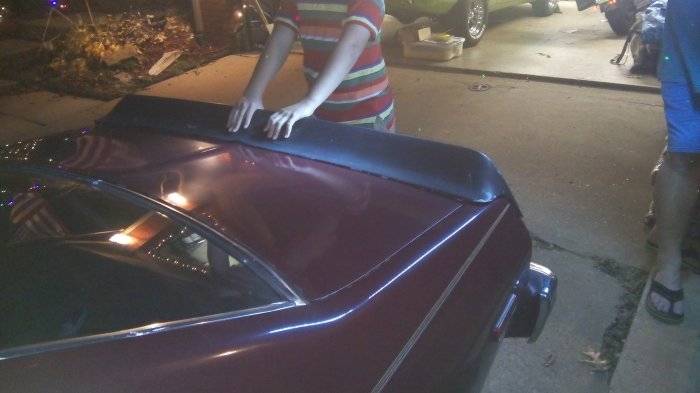

SO to followup on this old thread --- the kiddo has managed to get the spoiler smoothed and primed....we are now looking at laying out the holes etc.
Anyone know if there are any templates for correct hole drilling?
Also, looking for the right hardware....any ideas?
We know that this one piece is actually not "correct" for a 1980...but its what we have. :)

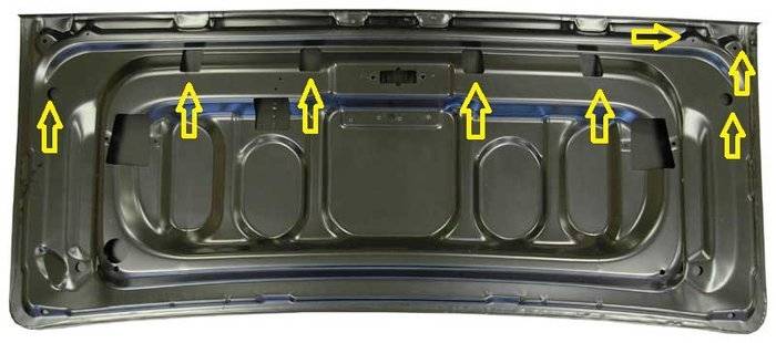

If yours is decklid mounted, then there “should” be pre-cut out holes in decklid inner support, which is roughly where the center holes attach to.
Most Chrysler products typically have pre-cut outs on inner structures, but no final holes.
This decklid is from AMD’s website for a ’71 ‘Cuda, which has spoiler holes pre-cut out. I’m not sure which holes, and marked ones I think might be used with yellow arrows (but could be mistaken – I’m not an E-body person).
What year is your spoiler off of – and I will look to see what hardware you need (if I can).

Spoilers were a new thing in ’70 – and manufacturing process wasn’t sure what to do yet, at that time.
According to AMD, there are four different decklids used for the ’70-74 Barracudas, ’70 with and without spoiler and ’71-74 with and without spoiler.
Just about all of the other car lines after that time, they just went to one style inner structure (which makes more sense).
The dealers were having problems with same thing with add-on wings/spoilers, hood pins and other items like that (like we are now).
I would bet a nickel that inner decklid structure holes are present.

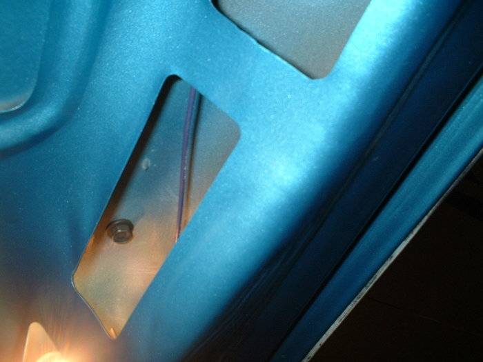

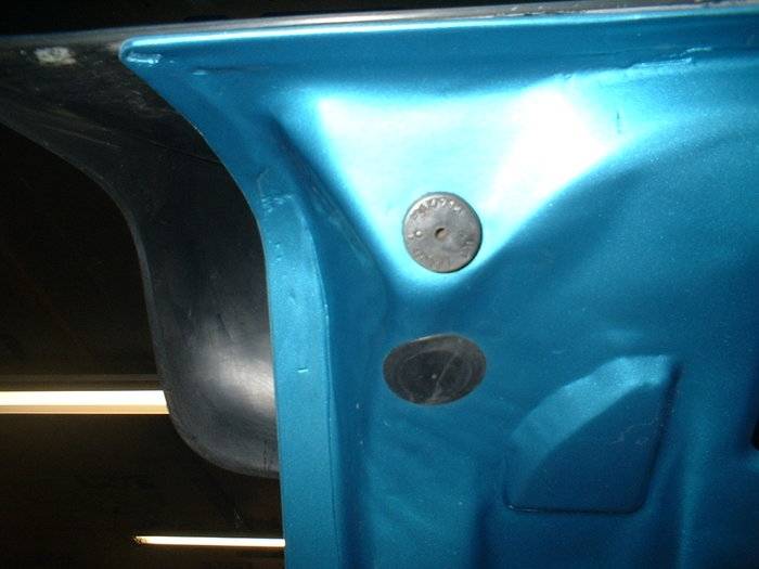

On my '79 Aspen the holes weren't there. The center 2 are accessed through the existing rectangular holes (but they don't line up with them). Helps to have small hands to get the bolts started and tightened. The outer 2 bolts, I had to use a hole saw on the inner structure. It's where the plugs are in the photo.
Like you, I know the one piece isn't "correct" for a '79 but it was $5 at the scrapyard so I went with it. Honestly at the time,,,,,,I didn't know any different.
It's been at least 25 years since I added the spoiler but THINK I put screws in the spoiler and positioned it on the decklid, then stuck a marker through the gap and marked the hole locations. Before drilling, also checked using measurments.
It's a good idea to replace the sheetmetal screw type u-nuts on the spoiler with actual threaded ones and use bolts. I felt a whole lot better that it would stay there that way!

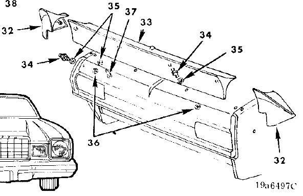

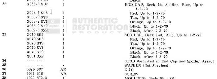

Not a whole lot of data in the part books. The ’76-78 books made you go in circles without any usable data. My ’79 book gave the most data:
The stamped steel nuts that Aspen500 mentioned is part # 6026687.
I found a vender online: http://rtspecialties.net/proddetail.asp?prod=6026687 but it may be available other places as well.
I agree with Aspen500, those nuts are flimsy – but I “think” I would rather have a nut fail than break the spoiler itself (maybe).

SO we worked on the spoiler over the long weekend....
Ended up putting bolts most of the way into the spoiler, adding a dag of grease to the heads and then resting the spoiler on the deck lid using a line we had drawn to show up where it should be...then lifted it back off.....drilled holes in the deck where the grease ended up.
Worked fine...had to ream a couple holes a little....
We roughed in the hardware with some slot-head bolts I had laying around. Gonna swap in hex head stainless hardware.
But one question that came up....how do you protect the deck lid paint from the forward edge of the spoiler and the mounting clips underneath?
The front edge rests right on the paint, for the most part...I can see that leading to rust later when the edge rubs through the paint.
Under the spoiler where the hardware is I was thinking we could add some layers of thick vinyl tape to help cushion the hardware....
