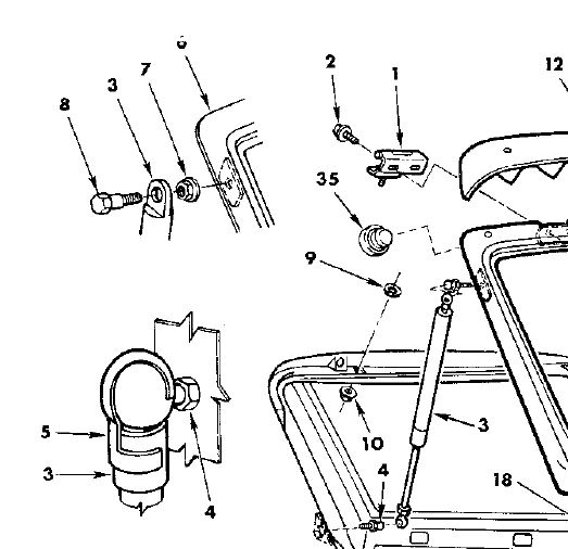

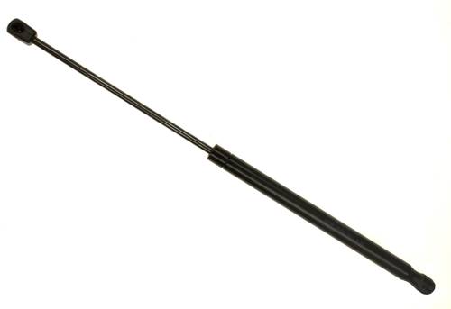

I looked at O’Reilly Auto Parts for my ’77 wagon.
Sachs # SG314001 (ball/socket style) is good for ’76-77 (only – well, also for a lot of Fords)

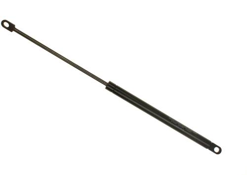

Sachs # SG314010 (bolt through style) is good for ’76-81 (all F & M), wiper or not.

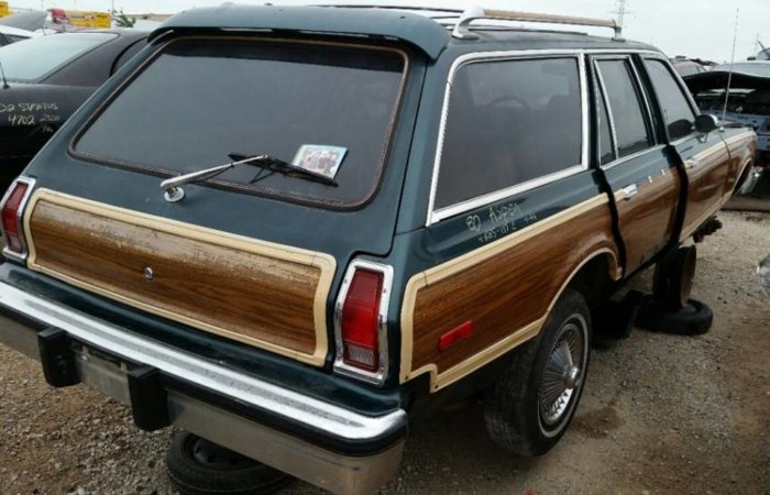

Here is a picture of an ’80 Aspen wagon with rear wiper. I was going to get the tailgate – but car got crushed before I had a chance to get it (one of those “you snooze you lose” scenario’s).
