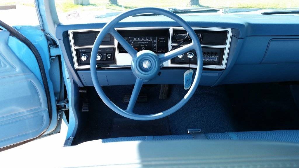

I have a ’70 woodgrain 3 spoke steering wheel that will fit on my ’77 Volare (non-tilt) just fine – but the chrome/woodgrain looks a bit out of place.
Look at my earlier post
Steering Wheel . Note, my daughter is the one modeling the wheel.
