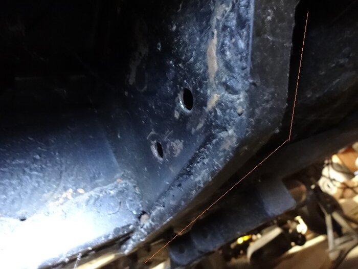

Bud ya ever notice that lil support strap on the body under where the front spring hanger mounts?
Coupes do not have them, one of my stealth mods is to make that strap out of flat stock ant mig it all the way from the frame to the outer body panel, that and backing plates on the hanger itself to spread the load.

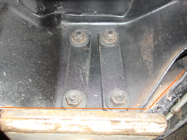

Yea, I will get one. I will get a better pic but it runs under the orange line, I used like either 3/4 or 1 inch wide flat stock just along the bottom lip. I use plates not but those are the load spreading brackets on the backside, I just had bar stock laying and used it.
You can see on the right side going up where I burned it in.

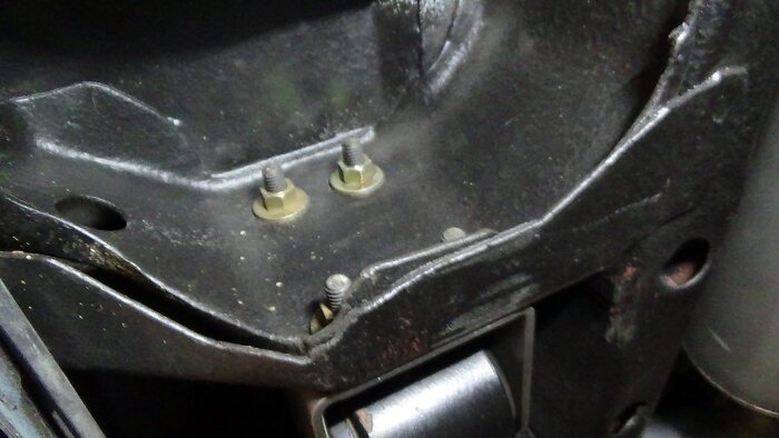

The wagon piece is in addition to what's there on a coupe? This is what my Aspen has. The hanger studs go through both pieces (two layers thick). Dang, starting to show it's age underneath.

Your pic shows the useless flap on the one side I trim it down and fill it. Pic here is ugly but almost 35 years ago ugly and it shows no signs of flex or distortion so ugly worked. I might of used angle iron with one side cut way down as I think that is what I used for the rigid edge of the 45. And my thought pattern then was just burn it and make it all one.
