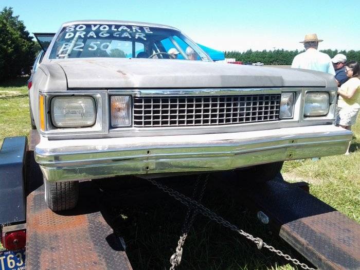

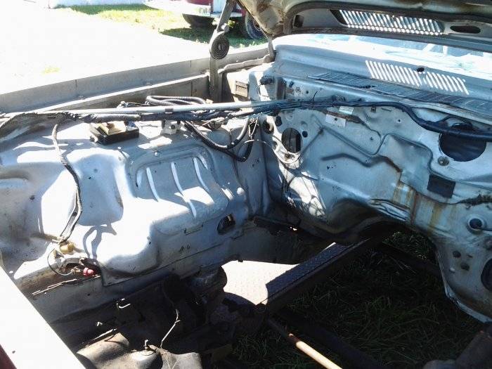

Speaking of mounts that convert slant to V8, This was 440 Volare's 80. I thought he told me the conversion mounts worked for both small block and bigblock somehow? Do they flip over or something? I remember him saying the Schumacher's were eliminating the rubber so "Solid mounts" for better results.

Billy, that car has /6 to sb conversion mounts.
