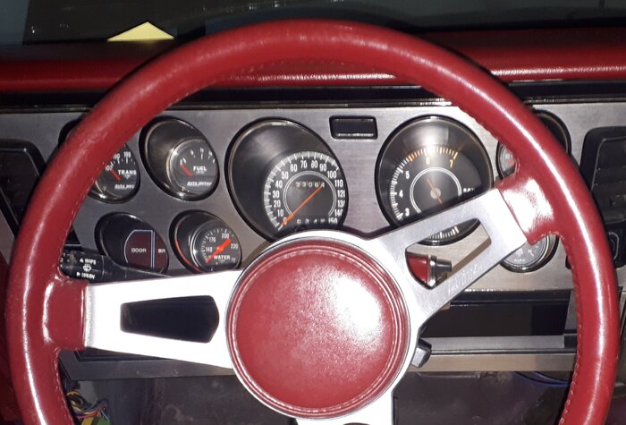

You can instal a 3 3/8” tach pretty easily in the gauge cluster.
2 1/16” gauges fit in the smaller pods.

That looks good. My fuel gauge is wonky...if it turns out to be the gauge and not the sending unit, I'll do this.

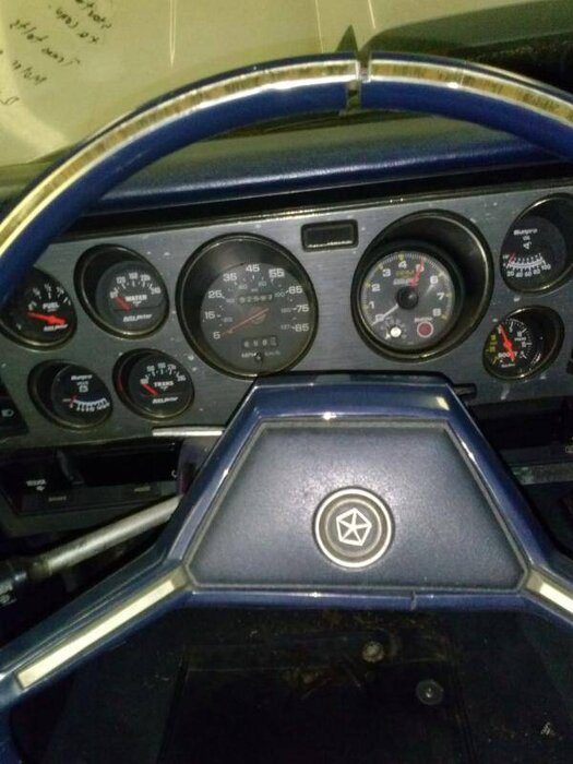

Well the speedometer fits right in and gives you a place to move the high beam indicator so you can put a 2 1/16 gauge in that position.
I mounted the 2 1/16 gauges in a piece of plexiglas shaped like the original gauge. The plastic behind it needs to be clearanced.
For the tachometer you need to locate the position and cut a hole in the back of the cluster with a small saw. ( X-acto) The circuit board has to be cut apart and spliced back together with jumper wires. The connector plugs need to be repositioned away from the back of the cluster for clearance. It really is a lot of work but as you can see it turned out pretty well.
I think the tach and speedometer are available in reproductions.
Very cool. Definitely gives me some ideas to play with.
