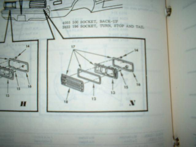

Appears the 3798253 p/n is a preformed seal but the same p/n is shown for Aspen wagon, Newport, etc, so it has to be some bulk material. Now my curiosity is up and need to know the real answer!
This is a photo of the parts book page (item 12).
Of course, the p/n I gave is from 1979 and most likely was/has been superseded at least once or twice since then and this number is no longer valid.
I saw that number being used in fender extension seals too, so I go with my guess it's Mopar material and not a die cut gasket.
Brads and Collectors also show the part number.
