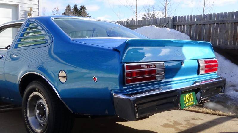

Might be a little late but,,,,,,,,,I did mine with the Eastwood Liquid Chrome system. It's tedious and you must follow the instructions to the letter however, it looks pretty darn good once finished. As for long term durability,,,,,,,time will tell.
Not exactly the best pic to see it but you get the idea. It's actually shinier than it looks. I had some good "in progress" pics of the tail lights until my old computer crashed and I hadn't done a back up for a while. Darnit.

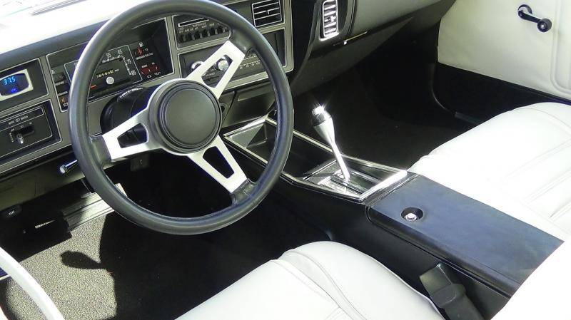

I used the Liquid Chrome on the interior also, like on the cluster bezel and did the edges of the air vents (now THAT was a study in patience!). As I said, follow the instructions EXACTLY, be patient and diligent. I used an air brush and highly recommend it for small work like this. Actually, it'd be almost impossible without an air brush.
I redid all the plastic chrome on the interior, plus some, and it turned out ALMOST like the vacuum plating. The multiple maskings were the worst part. My 50 year old eyes don't focus up close like they used to:sad7:
