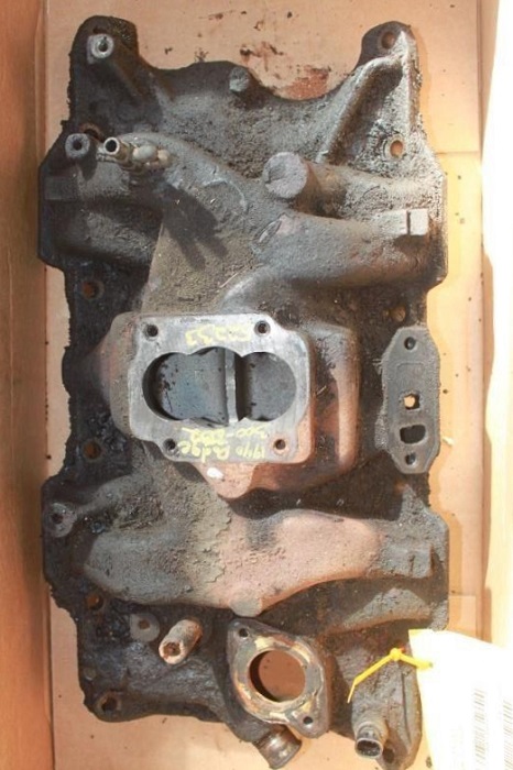

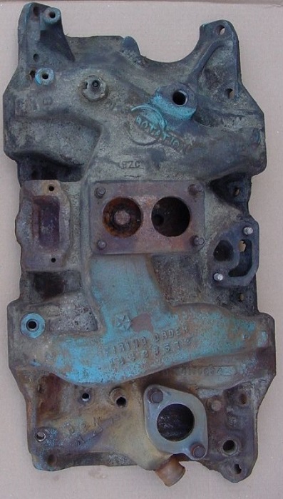

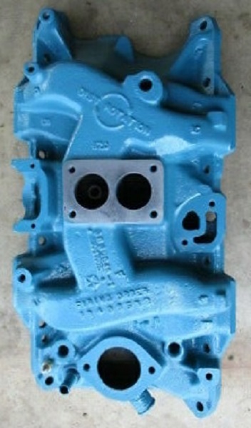

To help, here is a '79 (and newer LA vs, '78 (or older) LA:

I hope this helps.
