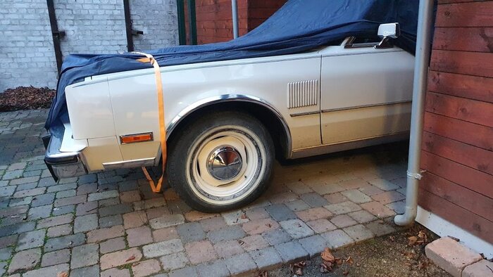

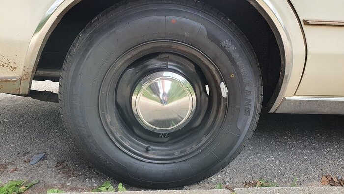

I also had to get rid of those wire wheel covers. But the muscle car look was not what I wanted for the old 5th Avenue

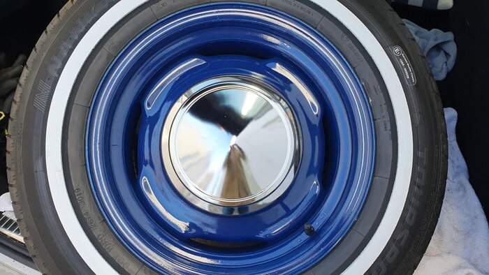

So I got me a set of cheap China dog dishes without any logo on it. Without a colour something was missing
One quick'n'dirty paint job on an old wheel with body colour shows the Mopar-correct colour choice for the rim. I didn't like that... there must be an other way
So it did it the wrong way and painted them in a dark blue that comes close to the colour of the vinyl top and the leather interoir

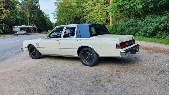

Luck was on my side and I found a set of correct alloy wheels, that soon needs to be shipped to Germany

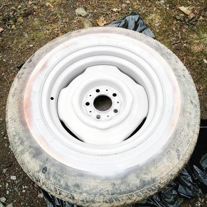

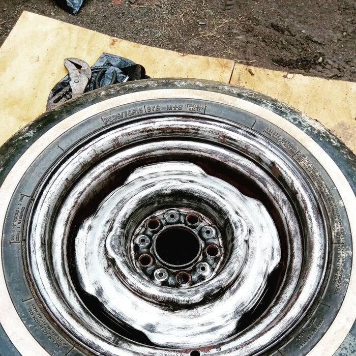

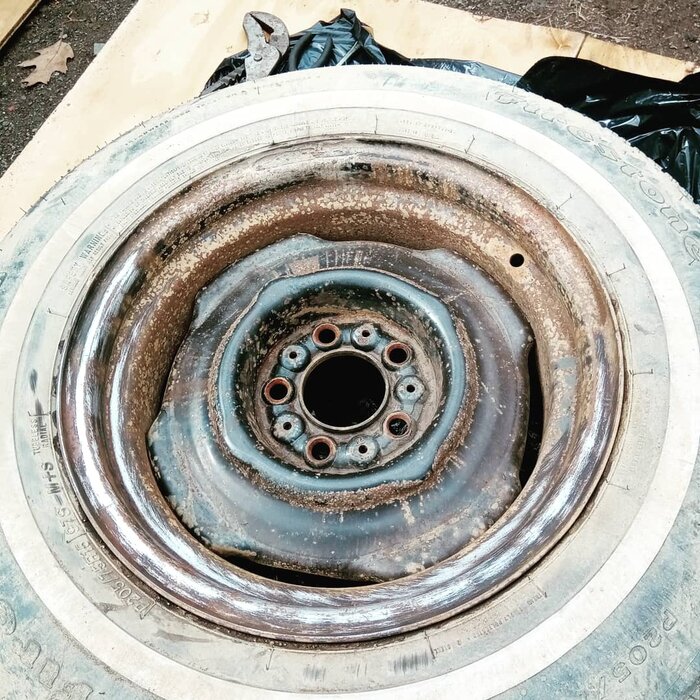

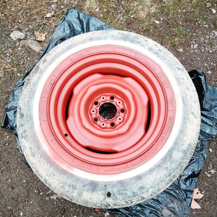

Got started on cleaning up my wheels yesterday. Cleaning up better than I expected, one is in filler primer already, ready to be scuffed down and sprayed black

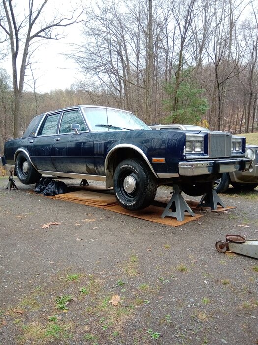

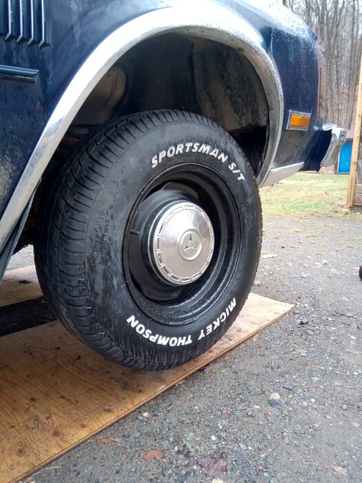

Wheels are finished, and mounted up with the new tires. 215/70/r15 fronts and 275/60r15 rears. The wheels turned out great, definitely plenty good enough for a driver quality car

Looks good! The 275s fit stock rims etc!
Yeah, stock 5x7s. They clear the leaf springs by a pretty good distance (can fit my hand in between) and at full compression has about 3/8 inch clearance to the chrome fender trim. Plenty of clearance to everywhere in the wheel wells. Mine currently sits about 1" off the bumpstops in the back due to sagged leaves, so pushing it down to full compression wasn't difficult lol
