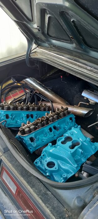

Hey guys, I'm doing a mild build on my 1987 Chrysler fifth avenue 318(big cam, 4 barrel swap, headers, and a limited slip 8 1/4). I know that they either came with the a904 or a727 and I'm not sure which I have or how to tell for certain, I know the 904 isn't necessarily known for its strength so if I do have it will I be okay to use it with a rebuild or should I swap out for something stronger

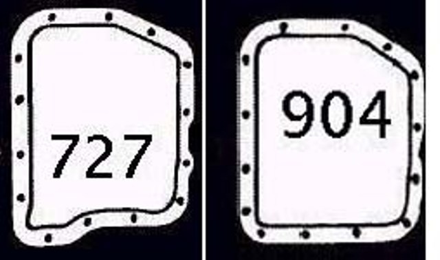

It's very unlikely to be a 727.
For what you're doing I wouldn't rebuild or replace the transmission until there was a reason to.

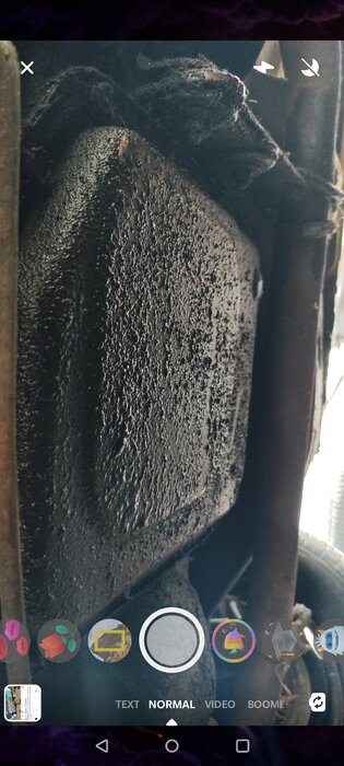

Okay thanks, I originally thought it was a 904 but then I saw a forum that made me question it, it only has 60k on it but the car did sit for 16 years however I have got it running and yard driving and the transmission does seem to be fine

The last picture shown – shows a A904/A998/A999 transmission pan.

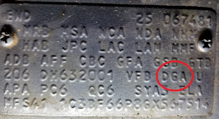

Your car should already have an A999 in it – which is great because of the first gear set and it is a pretty strong unit already. If you look at the fender tag, there should be a code "DGA" (which is for the A999), like this one:
This tag is from my '86 Fifth Ave.
