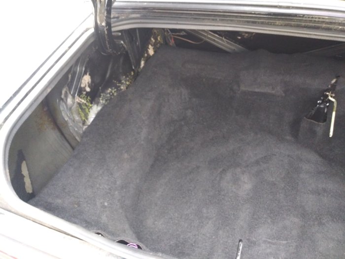

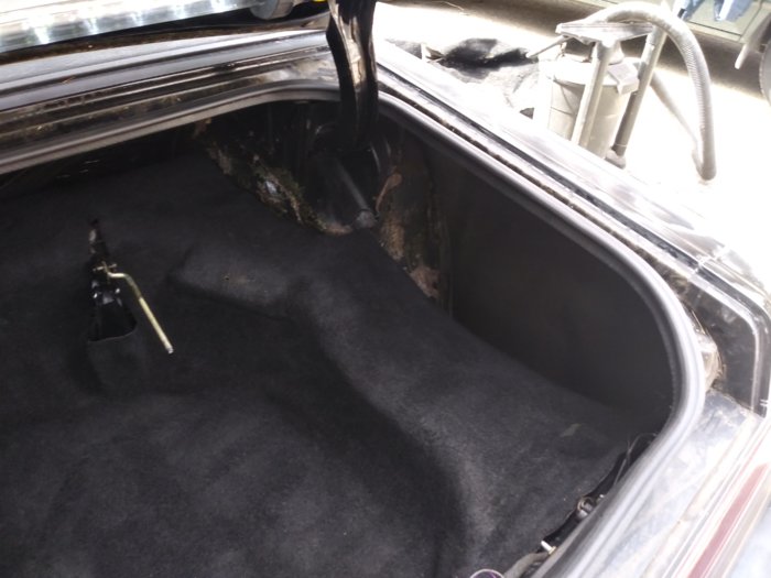

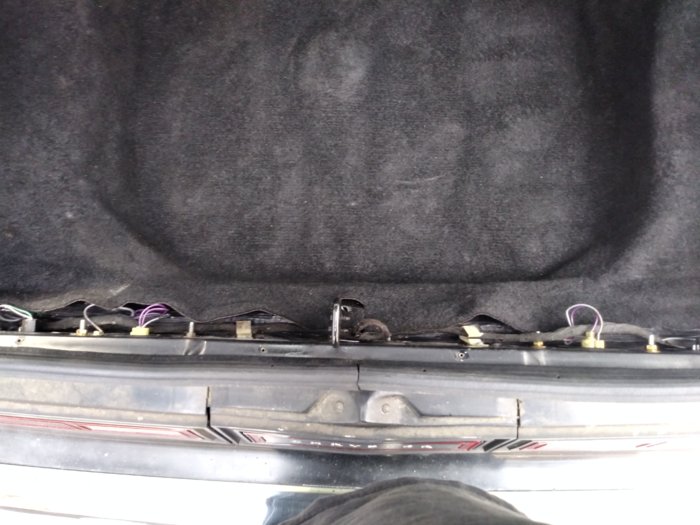

cleaning up the car since i have the time. didnt really do anything with the trunk when i first bought it so figured now was a good time. seems like im missing a bunch of trim most importantly the trim over the taillight wiring. also have no idea how the spare or at least the tools should be secured. im guessing in the rim? the other thing is the cover supposed to fit and cover completely the spare? what i have is a full size and to be honest the cover seems like its for a donut.
1,420
574
The tail light wiring is a cardboard cover with black carpeting on it. Very easy for them to get beat up over time. You are also missing the black carpeting over the trunk hinge area.
The spare tire goes on the back shelf upside down with the jack and handle in it. It was common for people to replace the compact spare with a full size one so your cover could well be the wrong size.

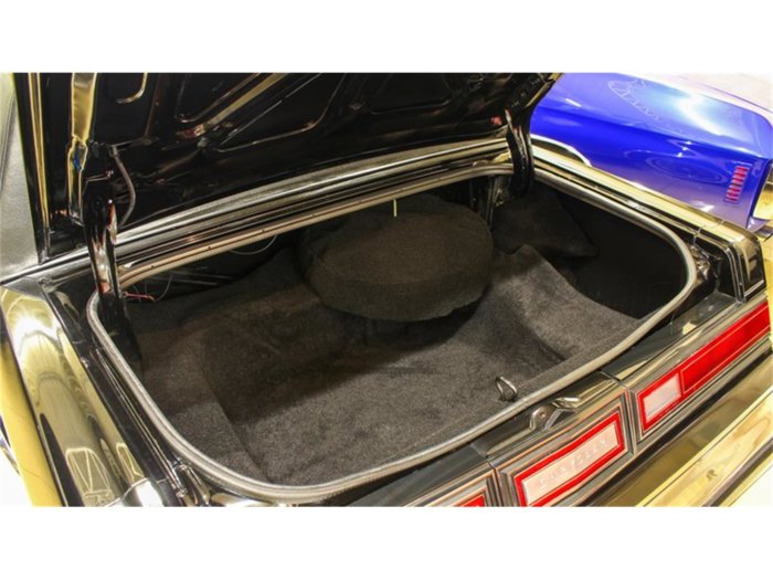

Here's a pic from online of the trunk.

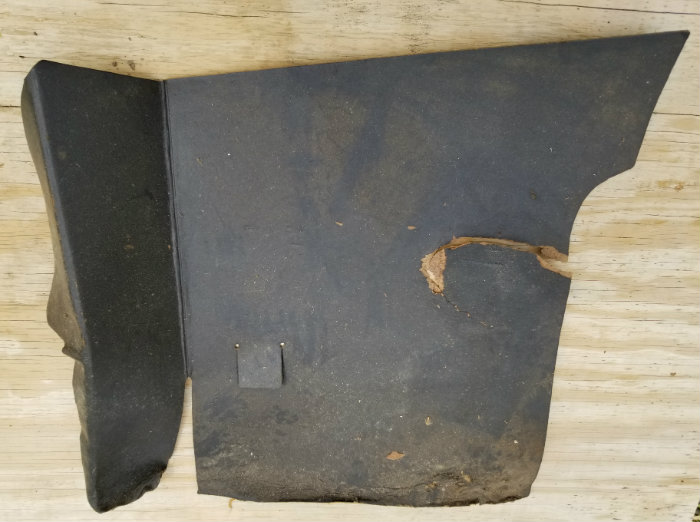

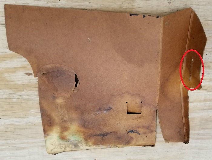

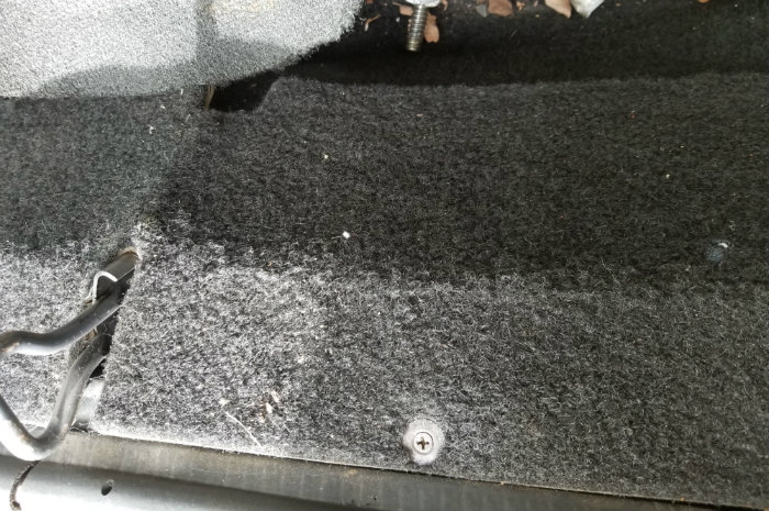

These are pictures taken from my '86 Fifth Ave (just now). All pictures are showing the Right trunk area – except for last two.

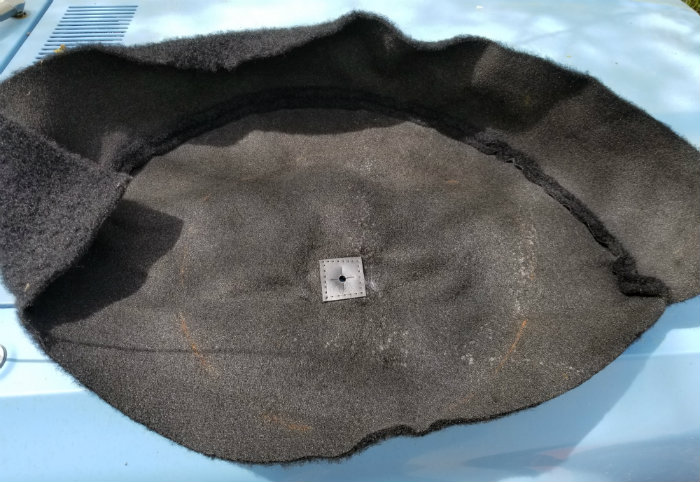

The underside of the tire cover (this one is a full size spare.

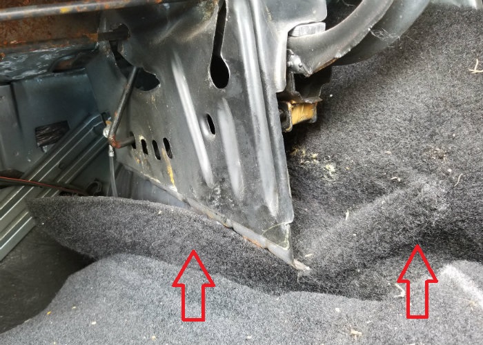

The red arrows show the carpet that goes over the wheel well (not sure what it is called). This is a separate piece from the trunk pan carpet.

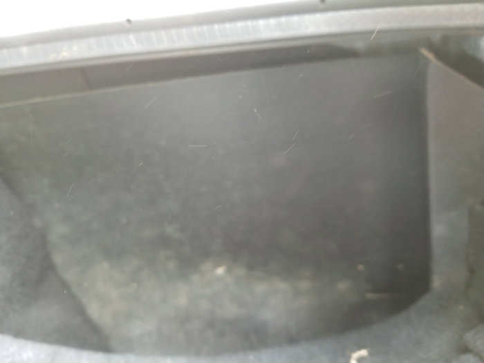

Cardboard (or whatever) liner. This part usually has a spot, or two, of glue to hold it in place.
In this case, the gray on lower portion of it is mold. I keep my cars outside and a heavy rain will allow water to get into trunk (past weatherstripping?) and collect in those side pockets.

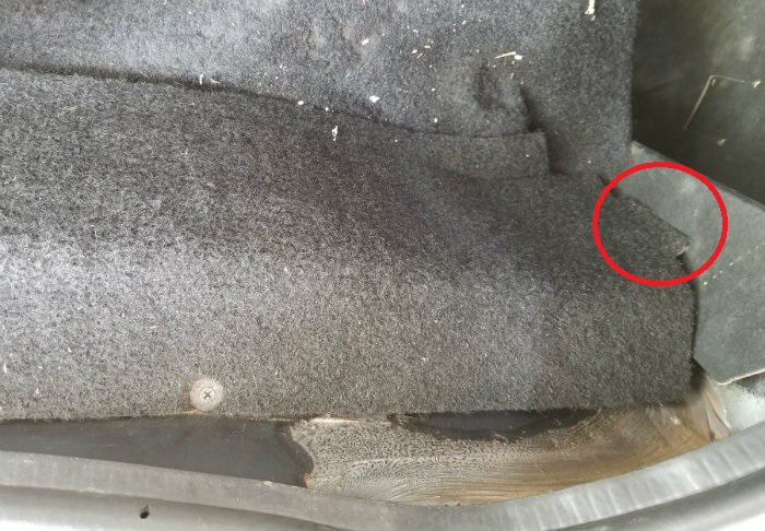

The piece missing covering the taillight wiring is one piece. It uses the same cardboard material but has carpet on it.
There is a tongue that goes into a slot on side cardboard (or whatever material its made of).
This cardboard I took out of of a car at a Pull-a-Part. This piece is for the Left side. I only got it so I could use it for a template to make a new one.
The slot showing there the rearmost tongue goes into.
This item also has water damage to it.
I hope this also helps.

Oddly enough the 70s ones had carpet glued to the rear quarter panels instead of the big cardboard pieces and it looked nicer.
I want to make those out of the plastic cardboard either painted black or black vinyl on it. that should hold but better then the original stuff, especially when it gets wet.
I've seen sheets of corrugated plastic that might hold up better. Not played with any, yet.
Aspen500, what are those panels made out of (or your best guess, if not sure)?
I'd say the panels are some sort of press board(?) Appears to be multiple layers (maybe 20 or so) of a paper material compressed and glued. Sort of half way between cardboard and Masonite. It's very similar to the factory backing on the door trim panels but a bit tougher an stronger. It says waterproof but I'd think it's more like water resistant. Although, I had a scrap piece setting against the wall of the garage a couple years ago, when I had the flood and it didn't seem to affect it at all, other than discoloring. You cut it with a utility knife, scoring 3 or 4 times.

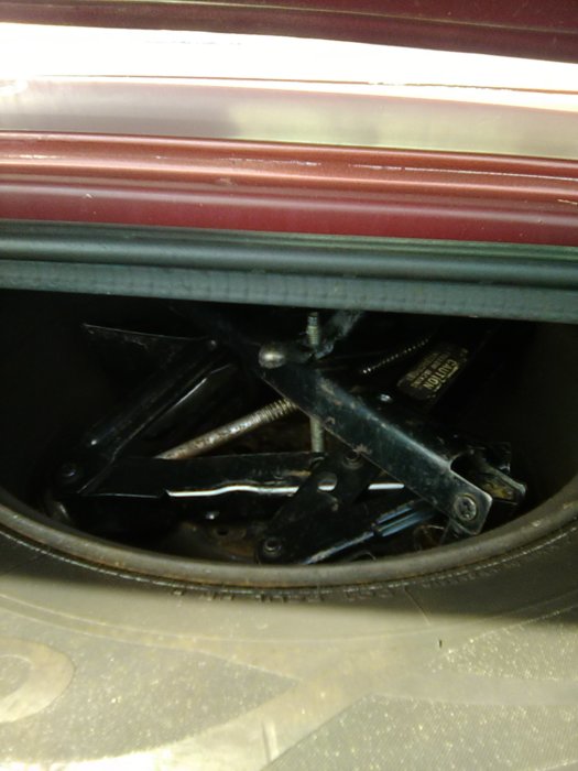

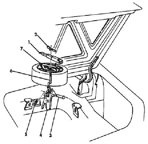

im thinking i have the wrong jack and wrench. i was unable to get them to secure in the spare. maybe im just doing something wrong. anyone have a picture how it should all fit together? i have a full size spare.

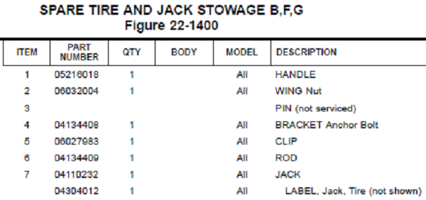

thank you MoparDan. i'll have to give it a try again in the morning. is there anything under the jack? like a plate that centers the rod on the rim or does it go thru one of the stud holes?
There is no plate. The spare goes (roughly centered) on the stud, then next is the scissor jack, the jack handle then the large nut. If you have one, then the black carpet cover goes on top. I thought my car had a sticker on the trunk lid – but looked and found nothing.
If you want a plate, I see no reason why one can't be made. Once the wingnut is tight, its not moving.
These are from my '84 Parts Manual:
