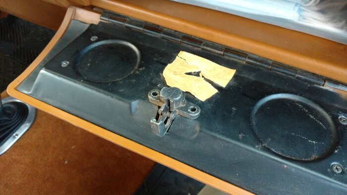

Does anyone know how to get the glove box lock out of the glove box door? I want to switch OY's keyed lock to the woodgrained glovebox door that I got from Silverd1973. Of course it isn't as simple as just removing the two screws holding it tight. Why would it be?
I think that it might have something to do with this tiny pinhole on the lock faceplate, but I don't really know. And, if so, what about the keyed lock that is on OY's original door? How do I deal with that? Any ideas?

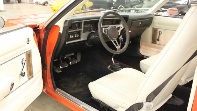

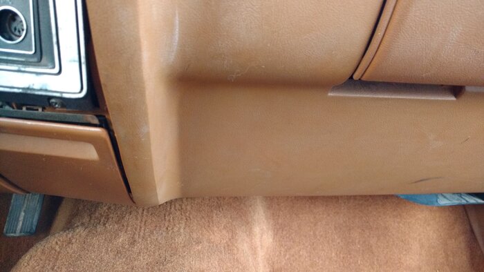

Also, could anyone give me the exact measurements of where the factory reverse light was located on the dash of the F's. I know that it wasn't available for the '78's, but I want to put one on OY's dash anyway. I still have the one from my '76 Volare. I guess it just gets spliced in to the reverse light switch wire, I don't remember, but if not would someone let me know? I'm pretty sure that it is mounted in the lower dash right near the center of this pic, below and to the left of the lower corner of the map light hole. But, I'm OCD enough to want to have it as close to the factory location as possible. If anyone has a pic of one, I would appreciate it.

The service manual only tells how to remove a keyed glove box cylinder. Maybe it works on a non-keyed one. Try inserting a stiff wire into the hole with the knob turned to the unlatch position and see if it pulls out. You may have to experiment with what works. Know I did it on my Aspen (no lock) but it was a while ago and can't remember exactly how it's done anymore.
The keyed one says to turn it to the lock position and remove the key. Then insert a stiff wire in rear slot of lock mechanism and depress retaining tumbler into cylinder. While holding tumbler down with wire, insert key. Remove wire and pull out cylinder. What "rear slot" they mean, don't know.
They have no illustrations on the procedure and I found it in the electrical section (seems an odd place for it).

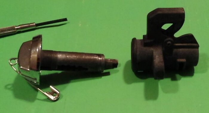

I have torn up a few of those glove box latches (and trunk side door latches) in my lifetime – but was shown they were meant to come apart after assembly (without destroying “stuff”).
I forgot how but looked online and found the answer – which is different between locking and non-locking.

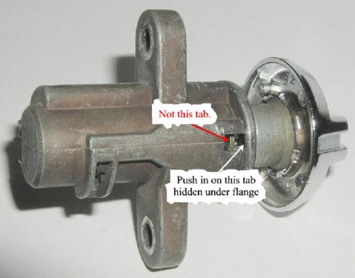

Here is what someone else said:
To remove it without damage, you do need the key.
With the key inserted and the latch in the closed position, you press in on a small tab which releases the lock cylinder and allows it to be removed. The common problem is confusion with regard to the tab to press because there are two tabs in close proximity and the obvious one isn't the one that releases the cylinder. It's the hard to see tab more toward the front of the lock. It took me a while to get mine to release; you sometimes just have to play around with it for a while...
Notice the safety pin. a paperclip works as well.
For the locking style.
Sorry, no help on the reverse lamp location.

Thanks also for the speedy replies. I did a little searching online, and found the following YouTube video on how to remove the non-keyed locks. It's on a Duster, but it's the same lock:
That little pinhole seems to fool a lot of people! I don't know why it's there if it really has no purpose. This video shows just what you are saying Aspen500. Thanks for your help.
BudW, that is good info for the locking one. OY's is a locking type, but unfortunately, I don't have the key. The ignition key I have works the doors and the hatch, but the missing glove box key would work that, and the rear storage bins in the wagon if it had them. Since I don't have the key, I was going to try to use an old "round" key from one of my other F's, and try to figure out how to change the lock cylinders to that key. I also have two rear storage bin covers with the locks from a parts car, and would also like to change those cylinders to the same "round" key.

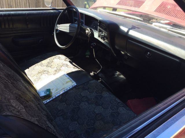

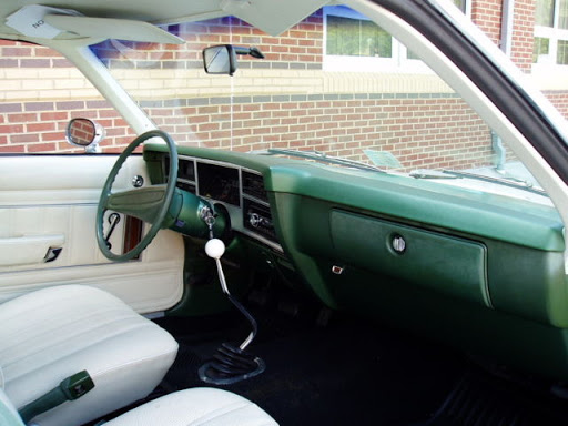

As for the location of the reverse light, I found these pics online. None of them are very good, but they show it is mounted up higher on the lower part of the dash than I remembered. It also seems that they only came on the '76's with four speeds. That would jive with the light that I have which I took off of my '76 Volare decades ago. None of these pics are very good, but if you expand them, you can see how high up it is. Again, if anyone has a better pic of the location, let me know. Thanks.

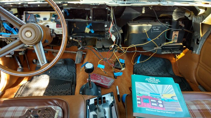

I decided to just switch out the entire glove box door rather than try to change the locks and that worked fine. Doesn't really matter to me that much. Then I decided that I'm going to just tear the dash apart and finally put in all the toys that I have been collecting for it. It would be so much easier to do all of it at once rather than piecemeal.
I have a maplight; a digital clock (I found the wire connector for it up in the dash); a reverse light switch (I'm just going to put it where I want); a minty dual speaker dashtop (have to find mini speakers); a beautiful AM/FM/CB stereo transceiver with mike and dash hook; a remote passenger mirror with the corresponding lower dash panel for the control, and a nice woodgrain dash bezel. Now for the job of finding where I put all that stuff.
I really enjoyed taking the dash apart and it was all pretty simple. I labeled everything because this will probably take a while doing it in my spare time (and I don't trust my memory).
The big thing is to bag and tag the screws as they are removed. That way, they all go back to same location, if 15 minutes later or 5 years later.
