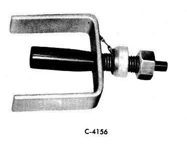

Specialty tools are not shown at the end of the chapter for this ... whats a tool C-3428B and tool C-4156

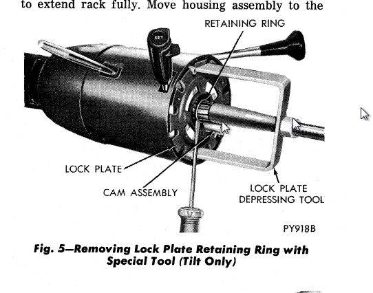

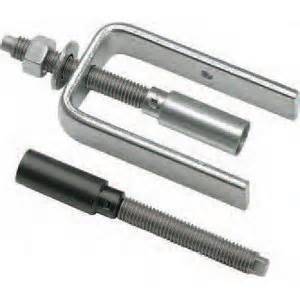

My guess is one of the tools is a steering wheel puller and the other is the lock plate compressor to get the clip off the steering shaft, so the lock plate can come off. Under that is the signal switch.

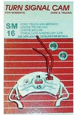

Most common is the tangs are broken off which are part of the switch assy.

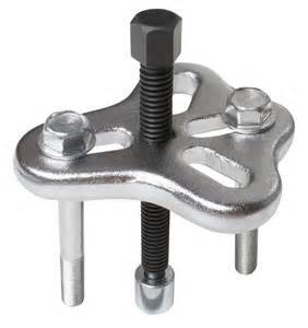

Miller tool number C-3428-B is a standard steering wheel puller – which you can rent from most auto parts stores (or purchase for about $10-15.
I found a link for this Miller / Mopar Tools C-3428-B Steering Wheel Puller but no need for it, when it can be obtained a lot cheaper elsewhere.

Miller tool number C-4156 is the steering lock plate depressor (to get snap ring out), and I think it can also be rented or purchased inexpensively.

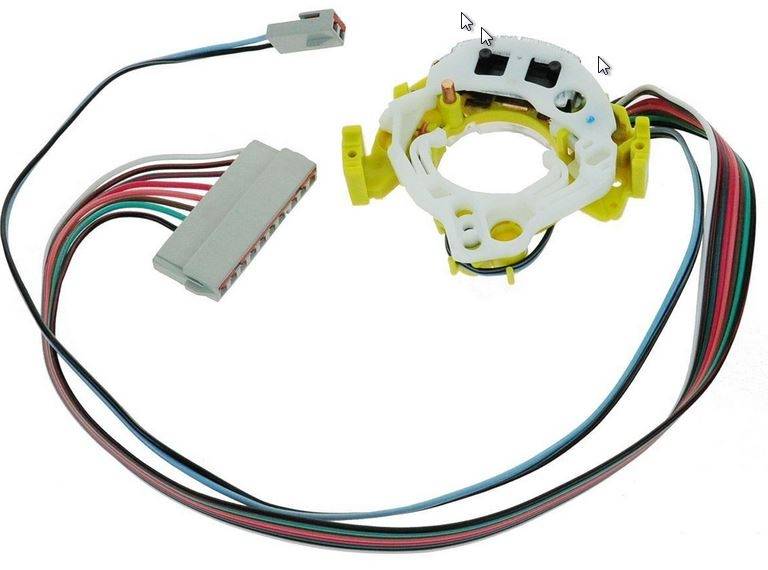

Once you get the lock plate out of the way, you will see the turn signal switch and may even find the broken finger at that time. Note: it doesn’t pay to re-glue the finger, just find a replacement.
