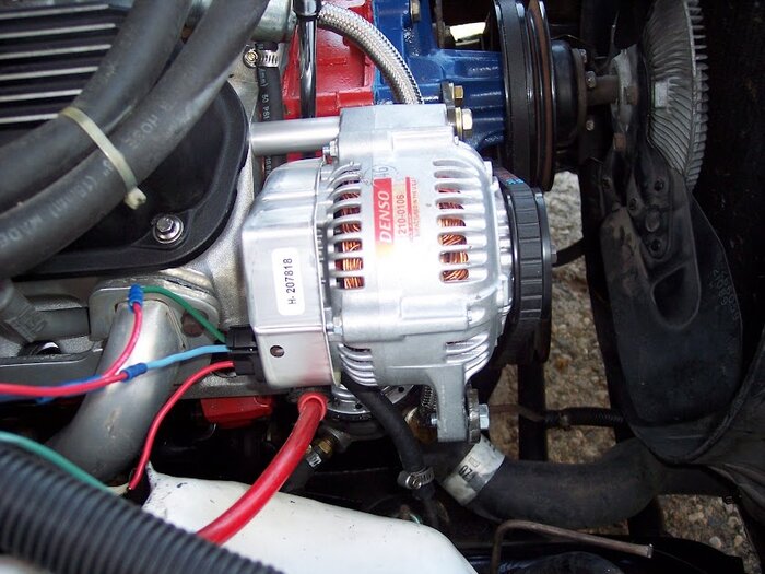

The factory charging system on these cars was junk even with everything functioning as it should. Swap it all out for a 60 amp Denso alternator. I ran one when I had a 360 for about eight years. Rated the same, but the idle charging is leaps and bound better. It won't dim the lights anymore. I would have kept it, but after going with fuel injection and electric fans I needed to step up. For a factoryish car, it's perfect.
Alternator
Bracket Kit
69-

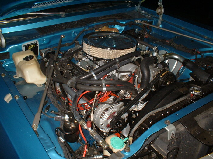

You can get a repro voltage regulator and they are made in USA, at least the one I have was. Only downside is the mounting holes are for A, B,E body not F. I made an adapter plate to use one. I wanted a good regulator and, for it to look "stock".
You can kind of see it behind the washer reservoir.
