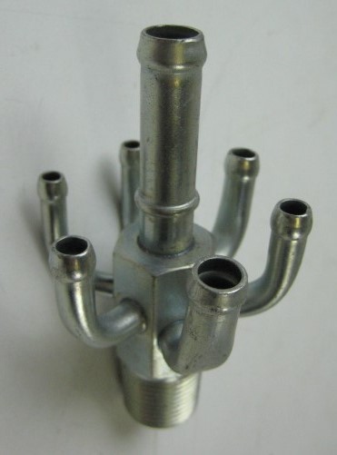

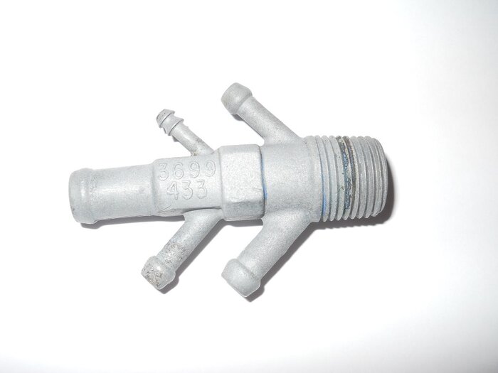

You have the versions with or without power brake (the large center one - which later ones used the carburetor for power brakes) then how many other ports. The top picture (post # 5) would be a 7-port tree and yours a 5-port vacuum tree. In almost every case I have seen, from Chrysler, is they always had one or two ports capped off. That is nice because you always had a place to use/attach a vacuum gauge to when tuning an engine.
