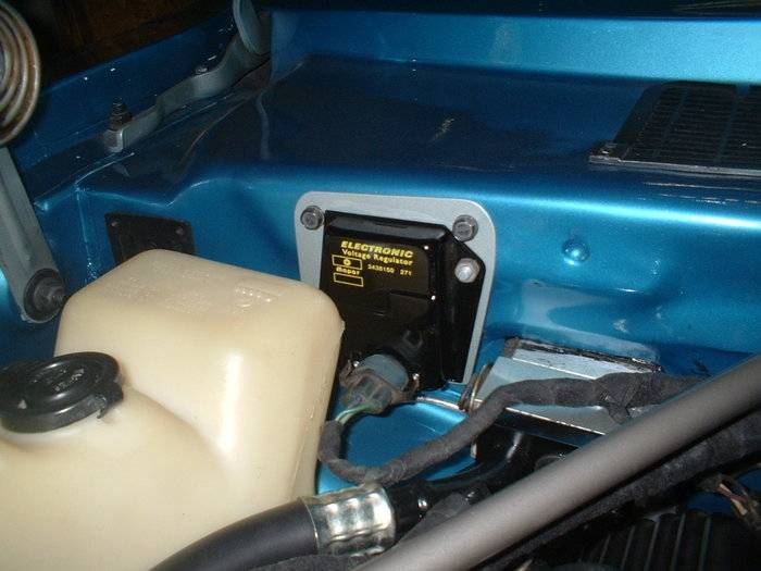

Put a repro regulator on my Aspen, made in USA and also because it "looks right". Had to make an adapter plate to mount it though. The repro is for A, B, E body and use diagonal mounting holes instead of 2 on the top like an F-body.
