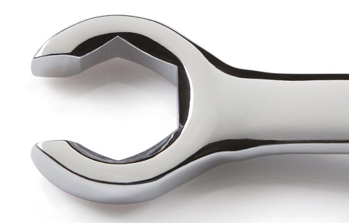

One way to tell is after car gets good and hot, then sits for 30-60 minutes, loosen and prop up the air cleaner housing. Get a couple of line wrenches (and not plain ole open-end wrenches) and loosen the fuel line to the carburetor.
If you have a couple of drips (or more) fuel run out, then vapor lock is most likely not the problem.
If you crack open that fuel line fitting and nothing comes out, then hit the starter a couple of cranks and check for fuel. If still nothing, then you do have "vapor lock" or fuel leak (or air leak in fuel line) somewhere.
