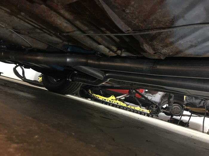

2 1/2 inch duel system, 2 1/4 “H” pipe, dump style behind the rear wheels, Super V Flo-Pro mufflers.
