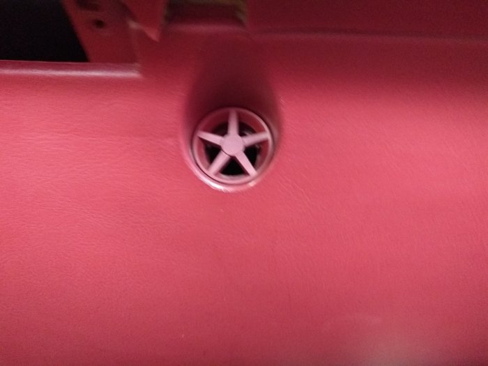

What is it?
shadango
May 30, 2016
466
40
Pittsburgh, PA
1981 Diplomat, under glove box.
7,085
This is only a guess but, do you have auto climate control? If so, it could be the air intake for the aspirator sensor (senses interior air temp). There would be a tube attached to the rear of it that leads to the blower housing.
Mr C
Apr 22, 2014
403
137
Correct.
shadango
May 30, 2016
466
40
Pittsburgh, PA
Thanks gents......the car doesnt have auto climate control....as far as I can tell.....
Mr C
Apr 22, 2014
403
137
I believe all M's had the hole regardless...but the purpose was for the interior air temp sensor. A single casting...cheaper.
