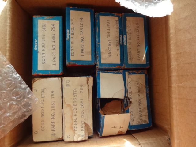

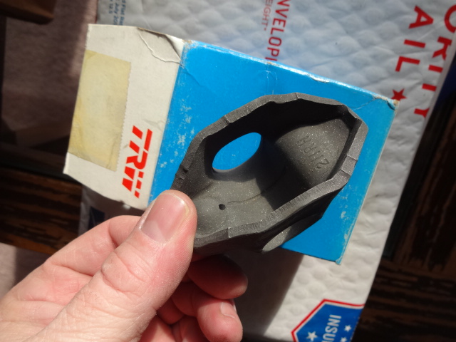

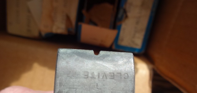

I snagged a set of older clevite 77 rod bearings for 22.50 shipped and a full set of oem rockers (trw) for $30 shipped off ebay of people just dumping inventory and not being greedy.
If you spend the time to look you can do alot with good parts if you dont have to have the latest cool looking packaging.

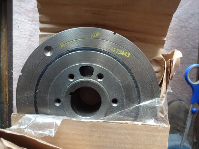

Got a nos 318 balancer for $40 shipped, made in the late 90s and much better the the $100 china junkers.

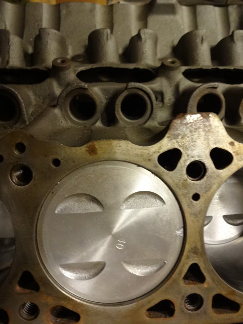

Hmmm.... Thats interesting. When i bought that cam, the guy told me it would work with stock application parts and i wouldnt have to mess around. The piston at tdc is almost flush with the top of the block from as far as I remember, but i can always check again. As far as the chambers on the heads they are 58cc, from what ive read on the heads. I know the stock heads were 65cc. I guess I'll call comp tomorrow and see what they say.
I can only go by what he said. I used.012 as "almost flush"
But if the pistons are down .057(11.2cc) and gasket(6.8cc) and head(58cc) then the Scr comes in at 9.58. That with an Ica of 57*, is predicted to make 161Psi with a Q of .085. ...... Can you buy gas in NY to satisfy that? Ok so make it an .039 gasket and add 2cc, now totals 78cc and the Scr comes in at 9.36, and pressure predicted at 157psi with a Q of .096. Better but....... .096 is a lazy quench, and kindof defeats the purpose of the 302 heads. you might as well have kept the smoggers, which if in fact were 65cc, and with an .020 gasket; then the difference is only 2.6cc or so. By the time you straighten them up, you wouldda been even.
The 302s can make a great combo with the right total chamber volume and Ica.
If I work the numbers backwards I get a 9.8Scr and a 61* Ica for 160psi and a Q of .050. This might burn mid-grade at WOT with full timing.
The combo is 5cc eyebrow pistons @.022 down in the holes, with an .028 gasket and the 58cc heads; for a total chamber volume of 74cc.
(652+74)/74=9.8cr
The 61* Ica comes on a 268/276/110 cam, in at 107. The VP comes to 122, about as good as you can get with this type of combo. She might like at least 3.23s(3.55 better), and a 2400TC(up to 2800 is better) wouldn't hurt with a 2.45 low trans. Yeah you'll need a SureGrip.

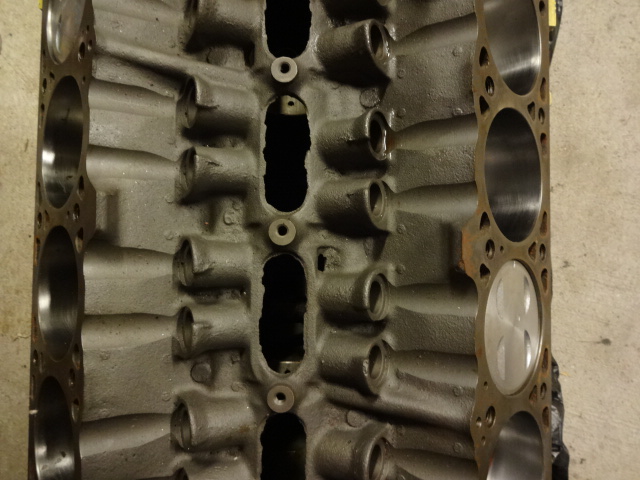

how far down in the hole are the pistons at TDC?
Measure and calculate, re-measure and re-calculate. Do it again if needed. Best to do it correctly and know what you have than to mis-match things and spend forever trying to figure out what went wrong.
Factory “installed piston heights” are inconsistent and almost always leaves the compression ratio less (or way less) than expected. I would bet $5 dollars (if I had it to bet . . .) your existing pistons are not even close to the deck. If crank and pistons are installed, it doesn’t take much to measure 'em. If engine is apart – well, that takes a bit more time to figure it out.
I have seen some factory small blocks, made in the late ‘70’s, that come a good ½” short of the deck. Not saying yours do – but it is always a good idea to measure twice and cut once . . . wait, I’m thinking of woodworking here – but same principle applies here.

Well i had already converted it over to a 4bbl prior to the tear down. So I have everything I need for that. My only concern is i bought stock replacement head gaskets, should I have gone thicker or will I be ok with the stock? Since I'll have to get stiffer springs for the valves
1,636
428
.070 was the norm for most the 70-s. .090 was seen from time to time.

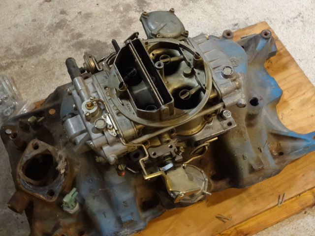

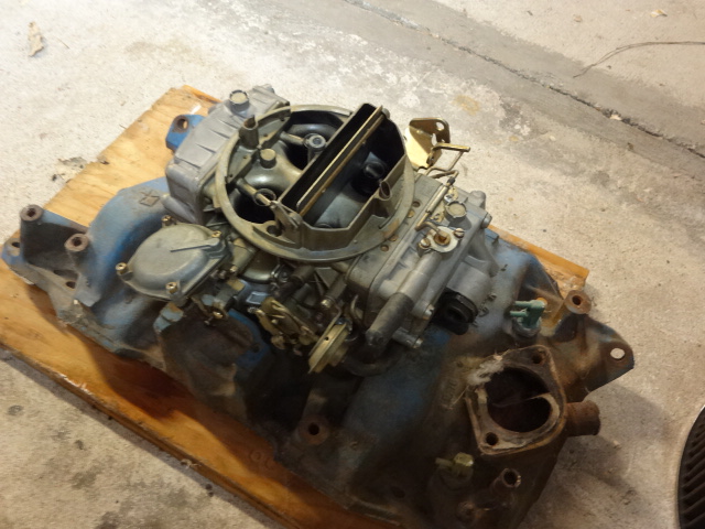

Bud, Ive noticed you have stressed the port mis match, on street light strip motors its not a really big deal, even the big port to port heads/intakes were a crappy fit do to casting and the difference in the oem deck height numbers.
Although Im not a fan of Larry Shepard, in his how to build max performance small block he nots the port difference on the 360 to 318 intake on page 100 he says its ok.
Many have done it and seen nothing but improvements. Id guess there lack of improvement was from a different area.

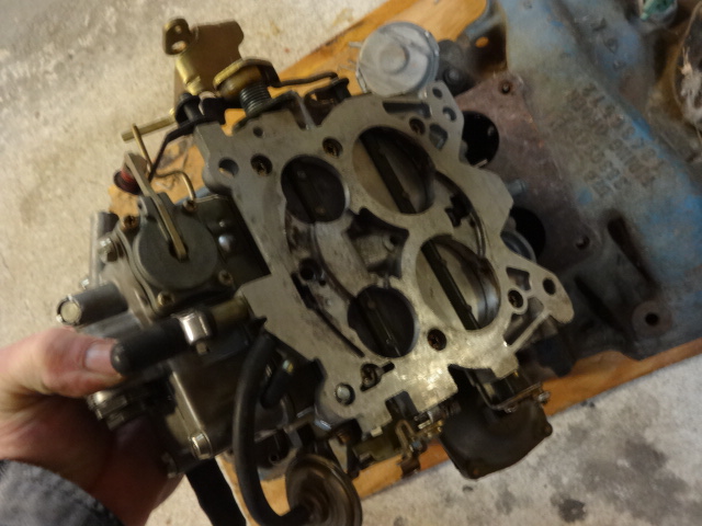

I ran your favorite carb and a oem 360 intake in a 318 in a F for over 20 years and never had a regret. Gonna clean it up, put a kit in the carb and back on a teener it goes. (But truth be told, im good with the carbs, never had good luck working in T quads and although I love quadrajets, they need to stay on gm-s.)

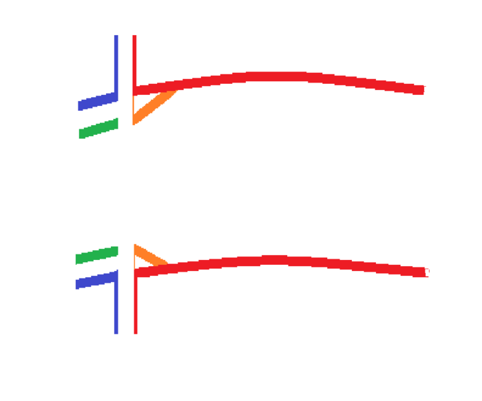

Bud if you think about it, a simple head gasket change say from a .060 to a .028 is going to change the intake to head port alignment (height), as I mentioned deck height variation will change it as well. Now on a race motor where most the time the intake is married to the heads for life one can spend a couple days in the mock up stages to get each port to head look and feel like a seamless fit and the end result shows but its not a fun job.
I think ive a few pics, I will look but the intake runner to the valve end up looking like one big seamless runner, but again its a one and done deal for the heads and intake.
i agree there. I have only worked on a few Q-jet's (Rochester QuadraJet), so not enough to form an opinion.

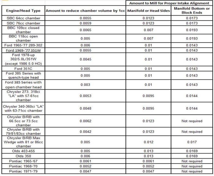

I agree and this is (sometimes) an overlooked aspect. When a person machines a cylinder head (removes material from deck of cylinder head) or uses a thinner/thicker head gasket - a person also needs to machine the intake manifold a corresponding amount to keep the intake ports matched as well as (on small blocks) machine the bottom of intake so there is sufficient gasket thickness that intake doesn’t push the gasket out (which on small blocks is a topic for another discussion to begin with).
In case of thicker head gaskets, a person will need to find thicker intake gaskets which are available if one looks hard enough.
“Some” intake port mismatch (like cylinder head deck machine) is nothing to worry about for street usage. Racing, yes, but not for street.
This chart was found online. Chrysler small blocks – the intake surface is not an 90’ angle from the head gasket surface which makes machining numbers a bit tricky. A person might need to break out the trig books . . . if you took trig in school.
