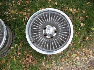

Looking at getting a set of wheels that are supposed to be for Mopars. I THINK they are from the 1978-1979 Magnums (XE or GT). I would like to have confirmation, if possible, and an idea if the center for these are available. Picture of wheel is:
They are supposed to by 15" X 8" on a 5 X4.5" bolt pattern.

Those are Mopar Urethane wheels...used first in 75 on Cordobas, but were thrown around the B body line up for a while. The center caps are the same as late version slotted road wheel.

Those wheels are ridiculously heavy and either 15x6.5" or 15x7"... I can't recall for sure. They did not make them in 8" widths. The centers are in fact specific to them--the slotted road wheel centers completely encircle the lug nuts, while these have breaks in the outer edge near each nut... but the small finishing cap itself is the same. As far as I know they were only used on '75-'79 B-body coupes. I've never seen 'em OE on a four-door... but that may just be because I never paid much attention to those unless they had lights on the roof.

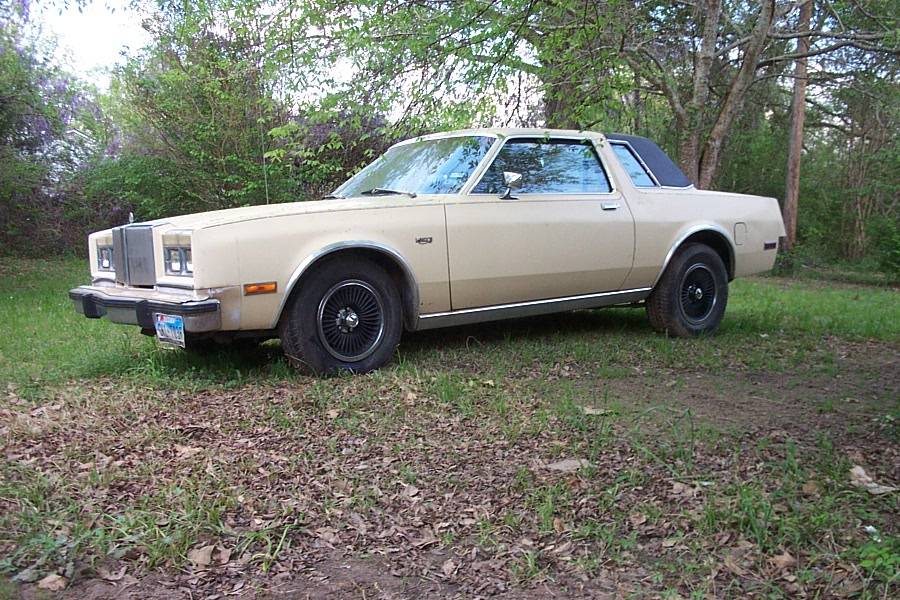

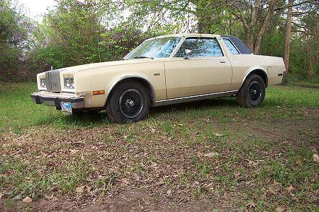

I put those wheels on my 80 Lebaron parts car.
Out of the 8 I had, Only 4 were useable.
Because the urethane does warp and pull away from the steel.
I still need one trim ring for these, there very thin and not much holding them on.
I had them lying around and wanted to see how they would look.
Better then the stock steel wheels that were on it.
Mopar did not limit their use to coupes...they could be optioned on other body styles.
I’ve been told by a couple of customers that removing the urethane wheels improved fuel mileage. I have no first hand verification to that - but as heavy as those wheels are, I could understand that.
The domes and rings are specific to that wheel.
I have seen this wheel on B and C bodies when new, but mostly on 2 door B bodies. My parts manual show they came on B bodies only – so maybe the C bodies may have had dealer upgrades (downgrades?) performed at time of sale.
Having that much un-sprung weight, can’t be good for performance enthusiasts. They might have well made the wheels out of lead.
Part numbers:
3699487 Wheel, 15-6.5” Polycast/Urethane (the only size available)
3580364 Dome (fits this wheel, only)
3580360 Cap (fits a bunch of wheels)
3461239 Ring, Trim (fits this wheel, only)
6029190 Screw, dome
3580134 Nut, Lug
